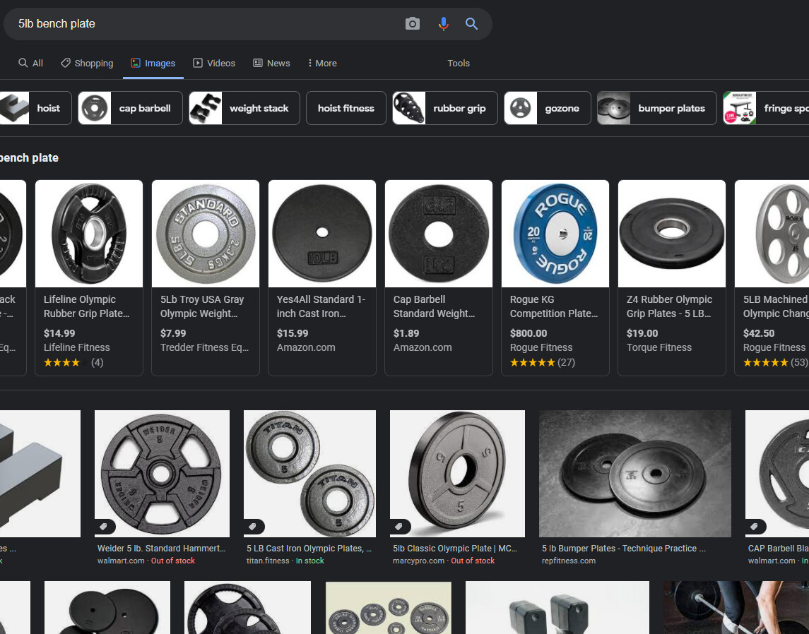

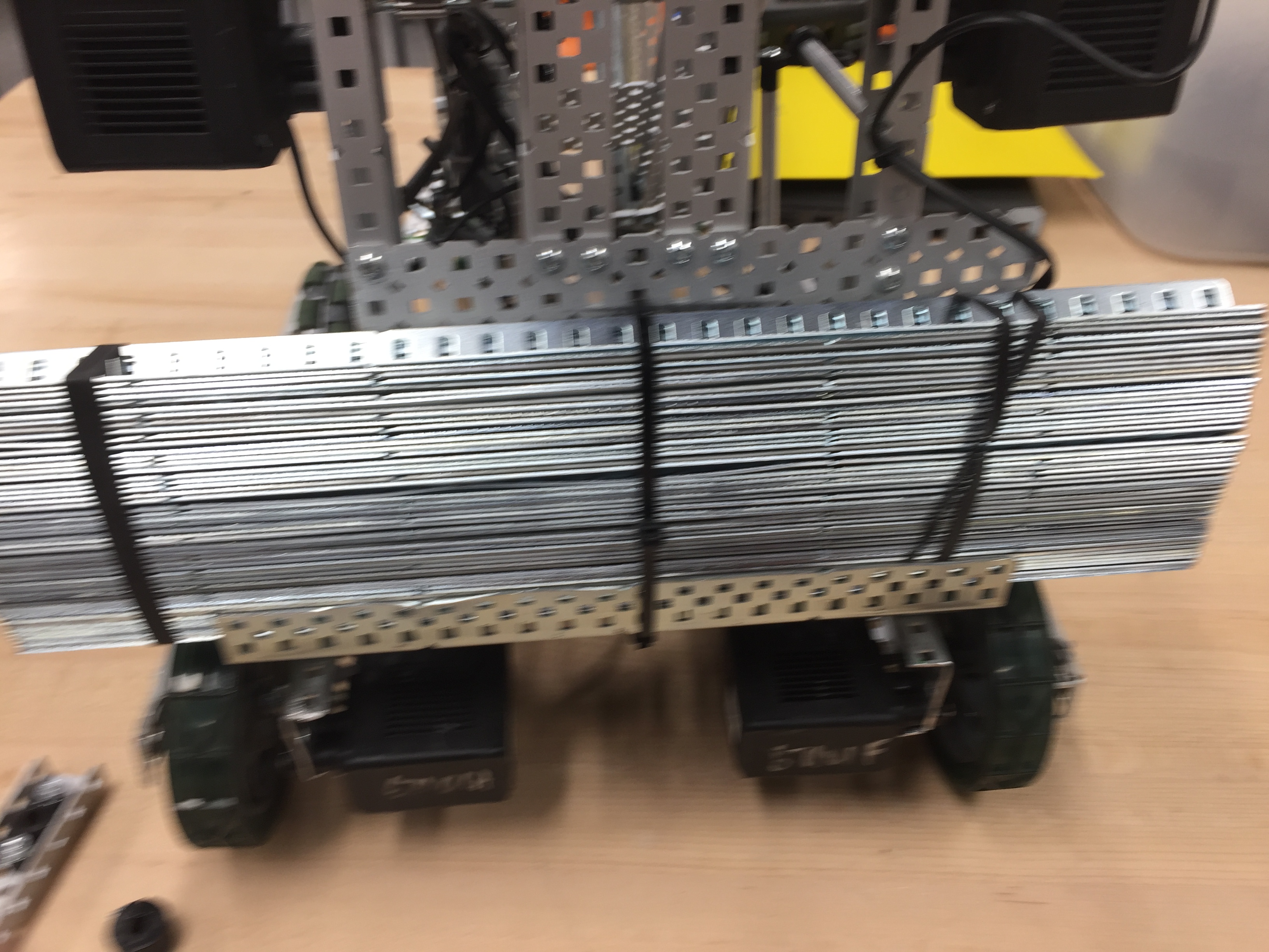

Last year we saw a clawbot get away with attaching 5lb bench plates with zip ties. Obviously wasn’t legal but eh didn’t really care.
But it’s a non-functional decoration referee! I swear!
I can’t tell if you’re being serious (sorry text over the internet sux) but won’t you run into stuff like
or
Yeah, but my guess is that if you are having to drastically change your robot during the tournament, your auton probably wasn’t that great anyway.
Please quote the specific rule in the Game Manual they were violating.
I am a not sure what you are referring to as “Bench Plates”. If this was an assembly of VEX structural parts, I see no problem. If a non-VEX structure component, then the question lies if it was decoration or functional. On the latter point, what contributed to scoring advantage?
Too little information in your response
You can’t get away with putting literally weights on your robot… :joy: Good luck explaining how it’s non-functional.
