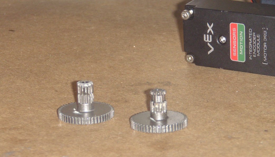

We’ve been to the competition this weekend and our flywheel accuracy was deteriorating through the day.
This is what happens if, instead of dropping the power to the motors as the ball goes through, you actually increase the power prematurely before the ball have been launched (see the graph few post above).
To make things even worse this was a gear in the motor whose IME was providing input to the speed control algorithm. Ouch…
Same thing happened to us, except in one of our catapult motors. Only half of it was worn down though, since we use a slip gear, and only load the motors part of each revolution.
we’ve done this about 10 times, we just have a stack of replacments
Wow, is it typically the gears on the IME side that get worn out, the side where the axle goes in, or both? I figure it would be a good idea to make these gears easily accessible during matches so that they can always be replaced before the elimination rounds to make sure it doesn’t break in the middle of one of those.
It is the surface that transfers the power from the motor/IME side to the power-gear side. In my experience this is always the first thing to break, but I never seen it being that bad. In fact, we were moving IME from one motor to another a week ago and took the opportunity to re-lubricate both motors. At that time the gears looked used but weren’t bad enough to be replaced.
Gear in the picture on the left is from another motor that was driving our flywheel. That sibling motor was driving 60T gear, which in turn was driving IME motor’s 60T gear, which in turn was driving 12T gear on the way to the flywheel. So there was a 60T:60T gear interface that must have been absorbing some of the shocks.
In any case, the final damage must have been done during a couple of hours of practice before and during the competition itself. I must admit that our speed control algorithm did more damage than good and we would have been better off just running motors at the constant speed.
However, we will try to fix it, such that it will protect motors from the shocks, in addition to providing power-boost to speed up the recovery time, after the ball is launched.
