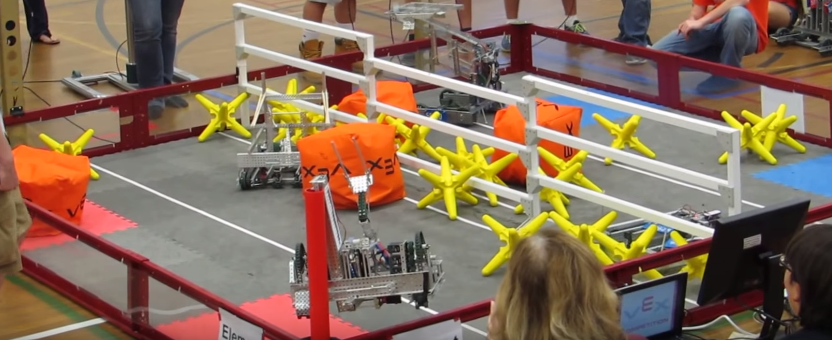

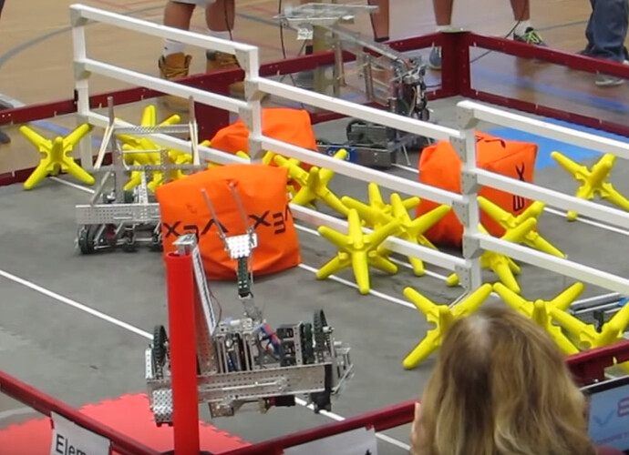

I took a picture of a match that was on YouTube.
Hopefully you can see the field enough
Unfortunately the angle isn’t sharp enough. Straight from the top of the post many not be either. Almost a completely above view would be optimal, like some of the shots at worlds finals 2015
