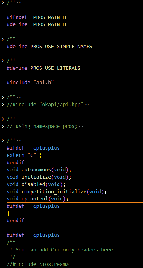

Thank you for your reply, to run the code all I was doing was once I downloaded it to the brain, I was just clicking the Run button. Is there anything else that I need to do to get autonomous running?
This is what my header file looks like:
It should run everything, but I am not sure.

But I am having an issue with this, as my entire PID code is an infinite while loop until PID gets turned off, but I cannot turn it off if the error is minimal, as if it overshoots, it will not oscillate and correct itself. Do you have any ways that I can use a function without these issues? Otherwise, I think a task would be easier and more beneficial, so could you help me fix my code with tasks?
For turning my code from motor encoder degrees to inches, are you suggesting measuring the diameter and figuring out how many inches that is? After that, I do not understand how to convert into degrees, especially with our geared drivertain. Thanks.
@EcstaticPilot Do you know if it is an issue with my code, or with uploading itself?
It is likely you are not running it correctly but there’s also a possibility there’s something wrong with your code. Here’s a picture on how to run it:
Make sure to run the autonomous code
Thanks, I will try this next time - hopefully it works.
