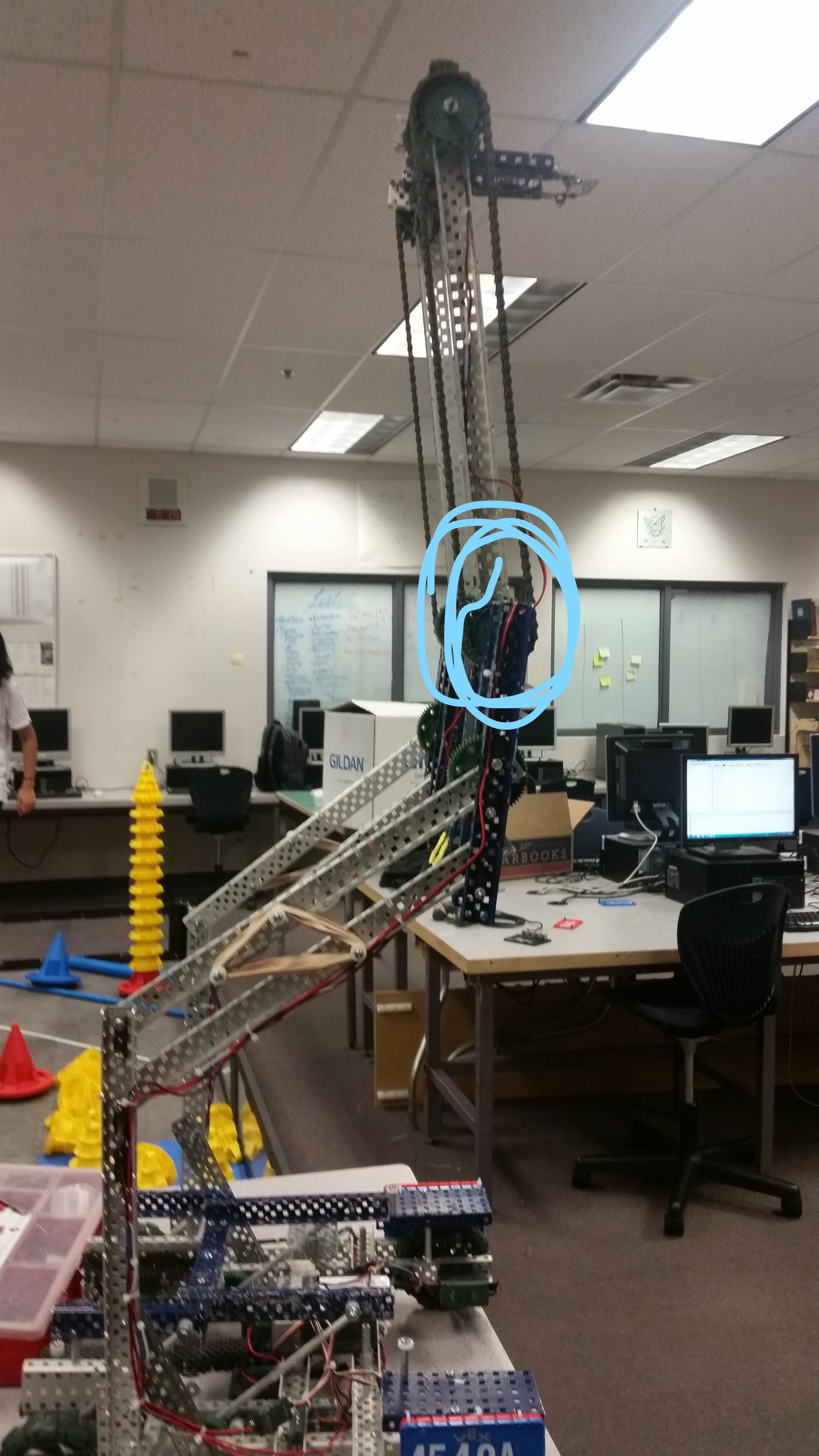

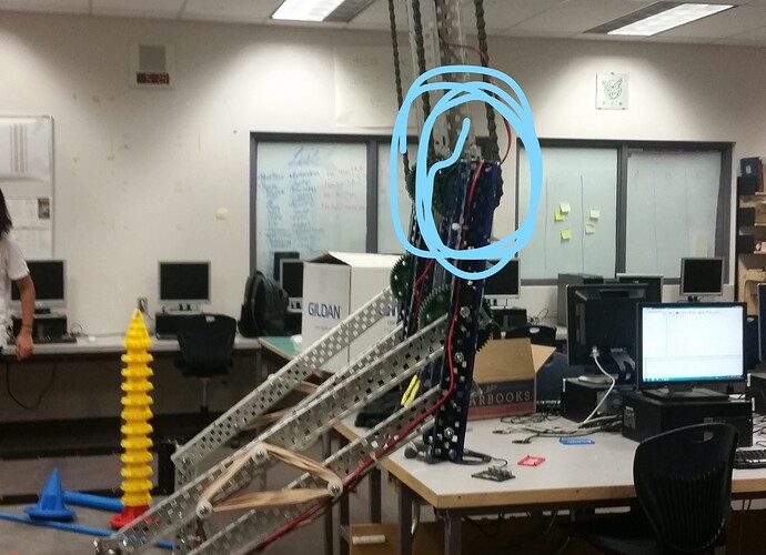

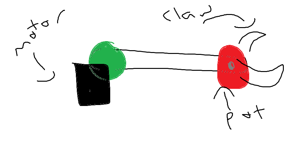

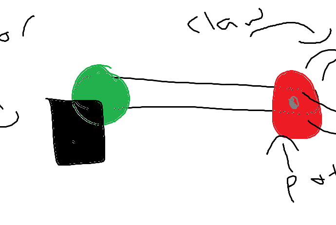

The thing is i cant gear it down cause i dont have enouph space so i cant use a potentiometer and i have a shaft encoder already on it and about running out of ports i only have one shaft encoder and potentiometer and then one for the chain bar
Do you need to gear it down? Unless you have the potentiometer directly on the motor, your range should be small enough for a potentiometer to work. Another thing you could try is to put the potentiometer on the end of the chainbar (I attached a bad MS paint illustration). I wouldn’t recommend an encoder, but I guess it would work if that’s all you can do. Running out of ports should not be an issue. Unless you have some sort of sensor on your chainbar, you cannot use any sort of control algorithm, PID or otherwise, because how can the robot know where to move the chainbar if it doesn’t know where it is?
Ok but the thing i dont get is how to code the chainbar to keep at the position i want it to be in. the reason why i wanna do that is because when the autonomous goes my code make the mobile goal go down and the the chainbar geos to the mid position and i want it to stay there until i tell it to come down. I wanna know how to code it to do that either using PID or something else. And i either will have potentiometer or a encoder on the actual chainbar.
this is where i will have the potentiometer or encoder
The low-tech option, which requires no sensors, is to figure out what the minimum amount of power is to hold the arm in position, and after you raise it to the desired place, just leave the motors on at that low power (probably 15-30, I’d guess). Since it’s autonomous, you know exactly what weight the arm will be holding and in exactly what location, so it’s not that hard to go the low-tech option, which happens to take very little time to implement.
