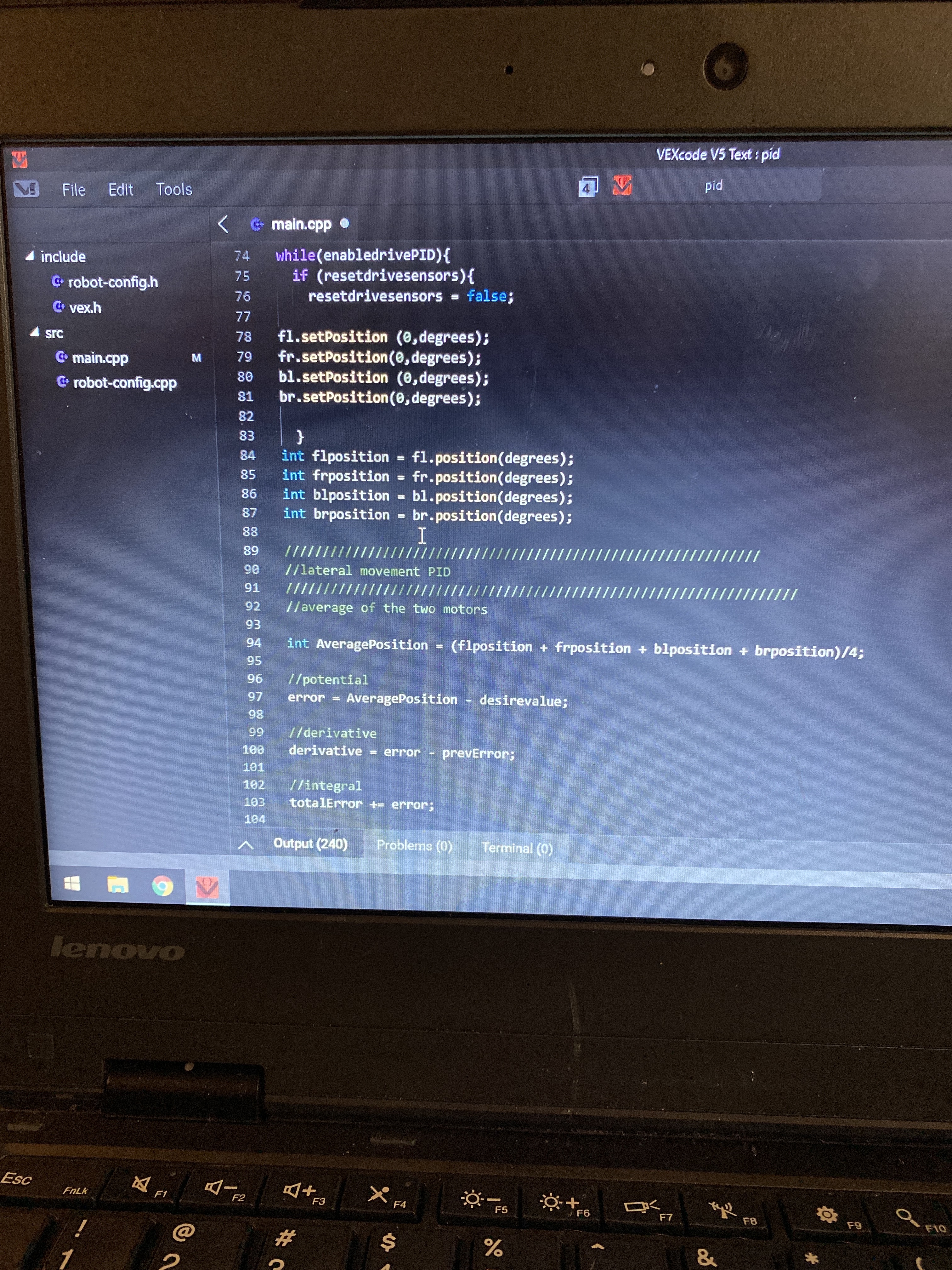

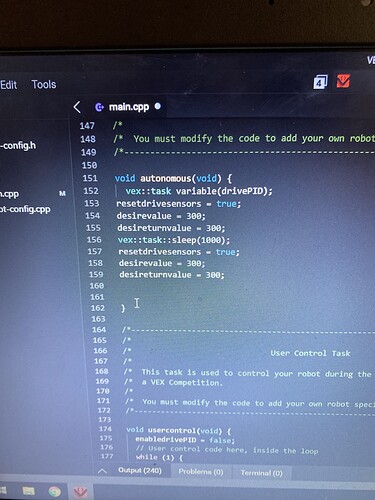

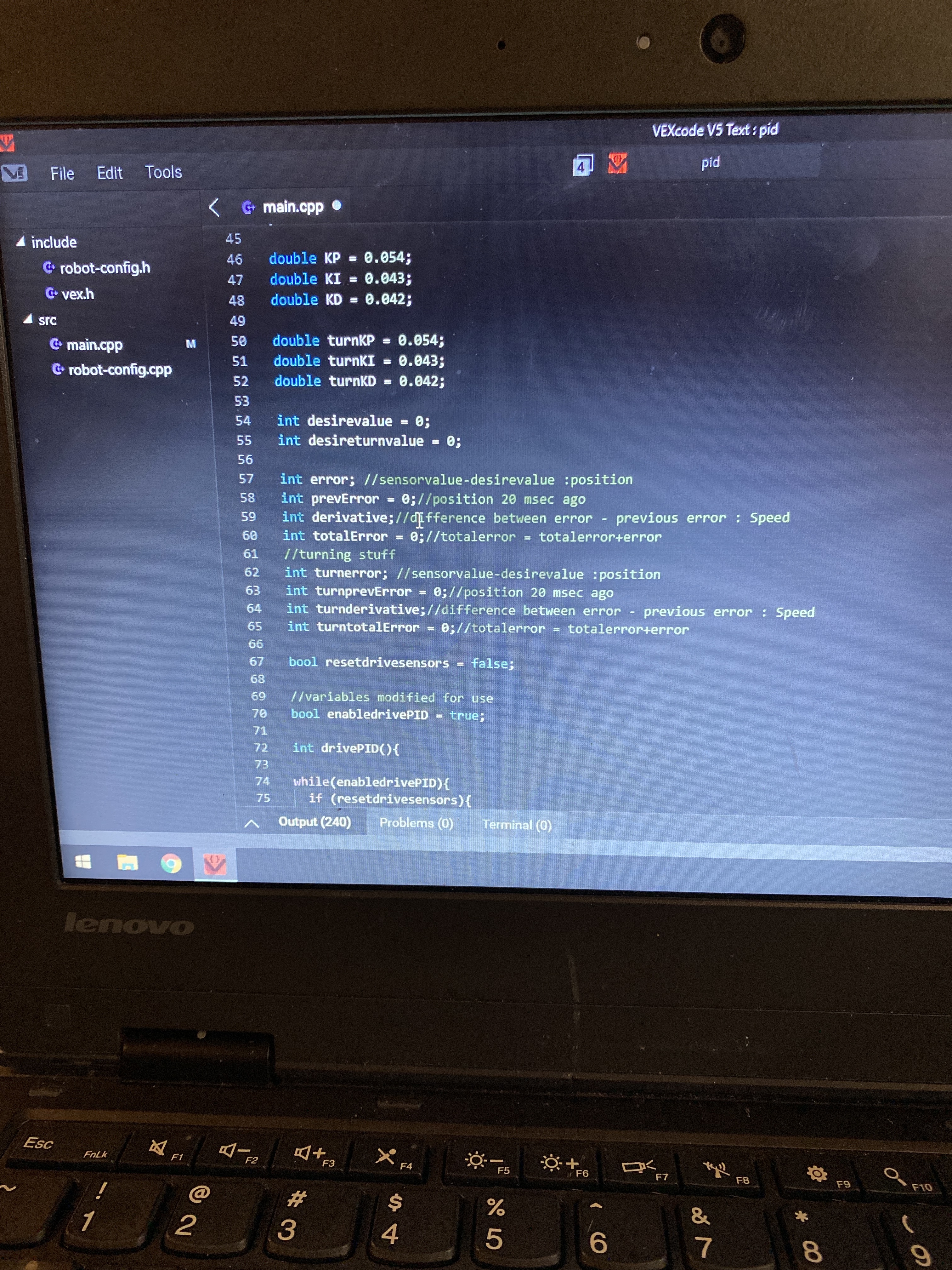

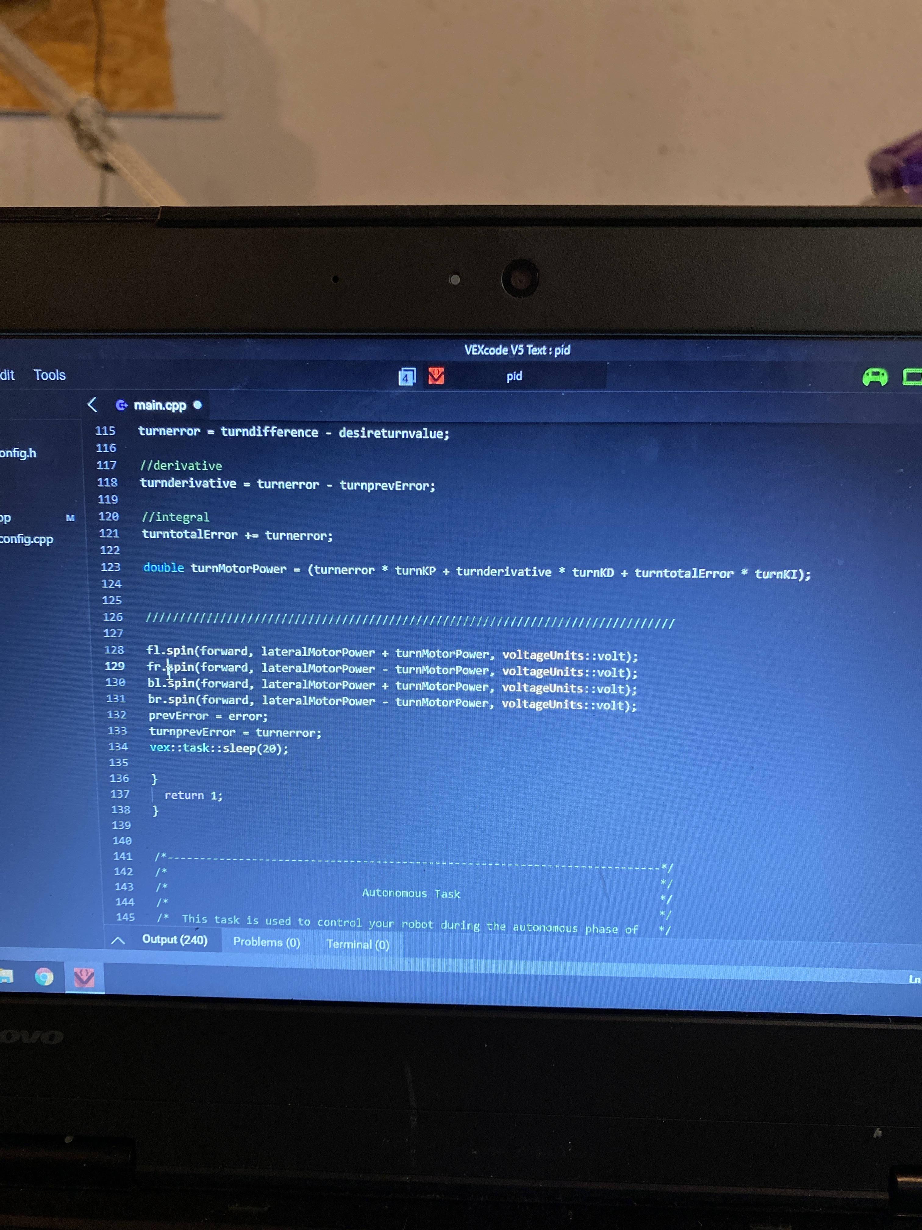

I have been working on PID for the past hour using @Connor ‘s video that he made (great video) and cannot figure out which values to change and how much. The robot just drives forward and does not stop. Anyone care to help?
I think Connor mentioned it but you may have to switch the desired value and current position when you calculate error.
And for tuning check out this link.
