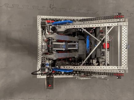

Hey all,
I have a teammate that’s been working over the past week on a PID loop for the robot’s turning. We have a competition next weekend, and we would like to get the PID to work soon, or else we’ll have to go back to our old code.
The program is intended to have the robot turn 90° clockwise and stop.
I’ve included the full program below (PID code specifically is 101-121) as well as a video of what the robot is doing; any help would be greatly appreciated.

void PIDTurning(double PID_Turning_Degrees, int Clockwise, int PID_Max_Speed) {
  //while((InertialL.heading(degrees)-PID_Turning_Degrees) > 1) && (InertialL.heading(degrees)-PID_Turning_Degrees) < -1){
    while(true){
    float PrevPid = Pid;
    Pid = (InertialL.heading(degrees)-PID_Turning_Degrees);
    pId =pId+Pid;
    piD=Pid-PrevPid;
    float Turnspeed=Pid*Pidmuilt+pId*pIdmuilt+piD*piDmuilt;
    leftDrive.setVelocity(Turnspeed, percent);
    rightDrive.setVelocity(Turnspeed, percent);
    leftDrive.spin(forward);
    rightDrive.spin(reverse);
    if(isPtoOnBase){
      PtoMotorLeft.setVelocity(Turnspeed, percent);
      PtoMotorRight.setVelocity(Turnspeed, percent);
      PtoMotorLeft.spin(forward);
      PtoMotorRight.spin(reverse);

IMG_1379-ezgif.com-crop
