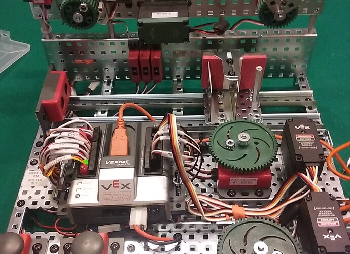

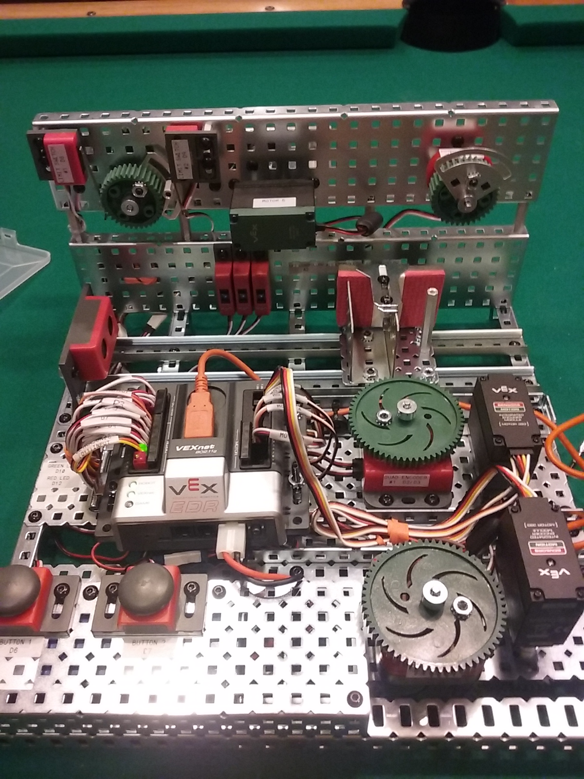

I been testing vex code in easyC the software my daughter’s team is using. I volunteered to help teach the kids different coding skills they can use to make more reliable and functional robots. I built a test bench for the kids and I to test ideas. I have been testing PID using the IME’s. I found I had to reverse the motor wires RED>>BLACK on both motors that are currently connected to Motor Ports 2 & 3 using the MC-29’s and IME’s 1 and 2 respectively. Is this an expected requirement. I have searched around the forums on how to reverse the encoder direction or polarity with results leading me to believe this is not possible.

My Test Bench
