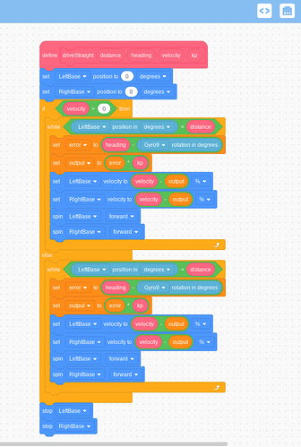

I just started my pid and when the code takes a turn it keeps turning and won’t stop. Can’t seem to find the problem. Please help.9007K Dr_Cnt1catupultAtounGodMode.iqblocks (34.8 KB)

This isn’t PID, its just a P loop.
Also it seems like your kP is too low.
Increase kP until it drives straight, if it oscillates too much decrease kP

I would guess your “LeftBase position in degrees” is probably going negative rather than positive as your test (the while part) assumes.
Well After fixing that, the main problem is when the robot has to backwards. When I put a negative output the robot goes the other way but does not stop. I made a backwards p loop but it did not work. Instead it will go little big forward and stop then go little bit forward.
In the video, you have distance = 100 and velocity = -100. Then you say,
while (position < distance) {
  drive at speed velocity - output;
There are a couple of things wrong with this.
  1. If you get off course, you will not turn and correct course, you will just go slower, since both your motors’ speed are decreased. One or other of your motors need to be velocity + output in order for the wheels to have different speeds and the robot to turn.
  2. Your distance is 100 and your wheel position is 0, so your going-backwards-while-loop condition, position < distance, is never true. This seems like it would make the robot just sit there, though.
  3. Your kP is zero anyhow, so you’re multiplying your error by 0 so you’re not correcting for it at all.
How about you copy the code exactly, first. Or you could try to make your own loop, and then you might understand it better.
That’s what I did I copied the code from the caption tape site. I am really confused on why it is not working.
It doesn’t match Caution Tape’s code.
Review your code very carefully and see if you can locate the discrepancy.
@Sharky_do There are multiple places in your code where you did not exactly replicate Caution Tape’s code. If you are going to copy code, not just the principle of code, you have to copy it line-for-line, since otherwise you won’t know where to start with fixing things.
More importantly, see the differences and then study the code so you understand why it works and your code didn’t.
