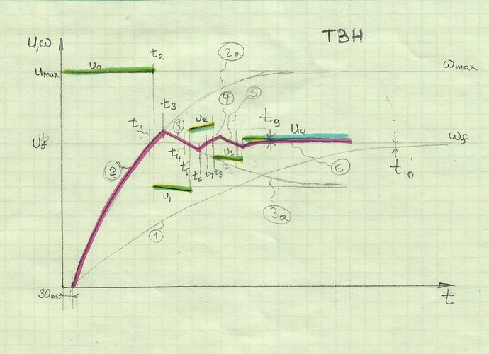

I wish I could share some more insights about PID tuning, but we are still debugging our own code. However, I could share a graph that I made to explain a simplified version of TBH to my team.
Let say you need to run flywheel at the speed (wf). If you already know the power level (uf) that would give you (wf) you can set it right away and have flywheel accelerate as shown with curve (1) until you are satisfied with your speed at a time t10. But this is slow and likely you don’t know required power level (uf) or it depends on some external variables?
Our simplified TBH will initially set power to 100% (u0). (You really shouldn’t do that in order to protect motor gears and prevent PTC from overheating) .
When velocity reaches your target (wf) at a time (t1) you take back half of the power and set it to (u1) and when it crosses target again you set it to u2 = (u0+u1)/2, then when it crosses again you set u3=(u1+u2)/2, and so forth until you are happy with the result at a time t9.
Notice that power curves (u1), (u2), (u3), and (u4) are not horizontal lines due to gain accumulation. This is “I” component that brings velocity curve (6) last few Hz to the target without crossing it.
The first thing you might ask is why would it overshoot if you reduce power as soon as velocity reaches the target? To answer this question lets look at the graph with more details:
First of all, you need to know that depending on which motor port you are using there might be delay in changing power of the motor. Let say we don’t know that ports 1 and 10 are fast and are using port2 that gives us 30ms delay on average.
So when you apply full power (u0) the motor only starts turning at 30ms with velocity following exponential curve (2).
At a time (t1) flywheel reaches desired speed, but our main loop runs on 20ms or even larger interval (to reduce measurement noise) and we only become aware of it at a time (t2). Algorithm immediately reacts by changing motor power to (u1), but by the time (t3) when the command reaches the motor controller we already overshoot.
Similar delays happen with the next segments of the curve and you end up doing several bounces before you accept the final speed at a time t9. The delays could easily add up to 0.1 sec or more on each bounce.
Clearly the cause of overshoot is accumulation of the various delays. So is there anything that could be done to reduce it?
First of all, you should run your flywheel motors on ports 1 and 10 to reduce command delay. Then you could reduce your main loop delay to 1ms. Finally, you can switch to IME where getMotorVelocity() could give you almost instantaneous velocity value. However, be aware that IME may introduce additional sources of measurement noise.
This all will reduce overshoot but not eliminate it. The real solution may be not to wait for velocity to cross target threshold, but start reducing the power preemptively, thus requiring the “D” term of PID.
