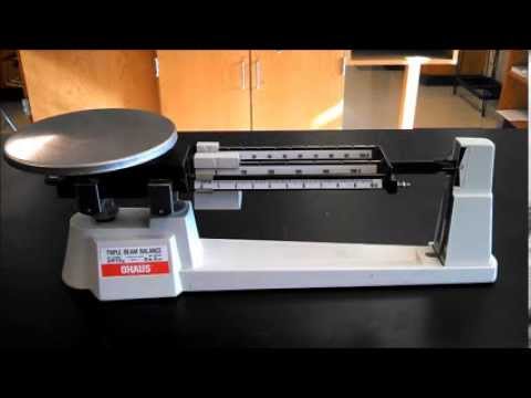

You would start at 0.0000 and you tune the decimal places one by one like weighing a scale:
Except think of it as the big weight is the tenths place for kP, the medium weight is the hundredths place for kP, and the small weight is the thousandths place for kP.
