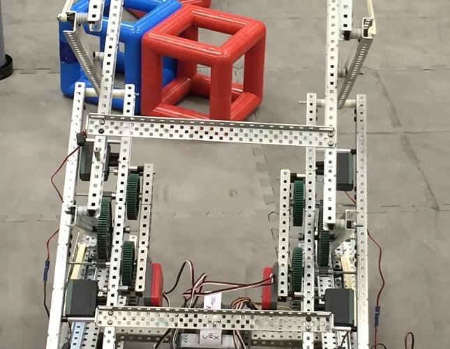

My issue-
I currently have a scissor lift that is geared 1:35 and has 4 stages. It reaches as high as I need and great except for a few nuances. One, the lift sometimes comes up a bit crooked, which hopefully can be fixed through programming. I currently have two encoders one on each side of the lift. The second issue with the lift is that it has quite a bit of play in it. I’ve spoken to others and it seems this comes natural with a scissor lift, but when I’m lifting with weight, about halfway up I encounter quite a bit of struggle, (this is the point where all the slack is being forced out) and it seems to break teeth, etc. I’ve seen many teams with smaller gear ratios lift bigger loads and I can’t determine what I’m doing wrong.
However many problems my robot currently has, this thread is about PID so I ask all of you. First off, what is a PID loop is its simplest form? Can it be used to combat the issues I currently face? And is programming a PID loop within EasyC even possible for someone like me(I consider myself a medium level programmer)?

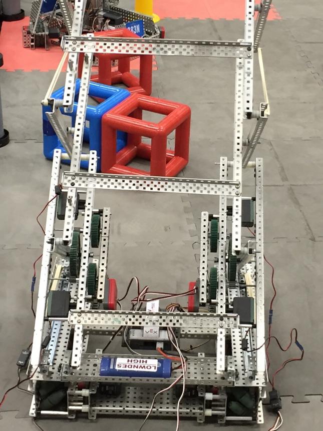

I am powering gears in the middle of the lift around a bigger green gear. The motors are driving a 12 tooth gear. I’m using two motors per side. The twelve tooth then drives a 60 which on the same axle a 12 drives a 84. I will try to post a picture soon. I’m not exactly sure how my build quality could be improved but I’m very open to suggestions, there are always things to learn!

I’m not going to try offer any real programming advice since I coded for the first time three days ago, but I’ll offer what mechanical advice I can (as well as +1 George’s guide).
I can see you’re using some elastics, but it may be that you could use more/better tuned elastics. Try sliding the axles out of your motors and trying different combinations of elastics, with and without cubes. you can also test for friction like this.
As far as your build quality goes, it does look solid, but the devil is in the details. Firstly, you could try (assuming you can spare the metal of course) using 3 channels per X so that your joints aren’t cantilevered. Another alternative is to pass your joint bolts through one piece of metal and bearing block, then use a keps nut done up tight to eliminate wobble in that bolt, then lock nut the other piece as normal. Lastly, be aware how tight your lock nuts are. I find they should be done up tight enough to eliminate practically all wobble, without adding ridiculous friction to the joint (it’s a fine balance).
