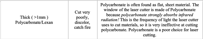

For the "no"s in that column, I mostly consulted one of my favorite PDFs:
It lists “thick (>1mm) polycarbonate” in the “NEVER CUT THESE MATERIALS” category, and has the following to say about it:
<1mm polycarbonate is listed under “safe to cut”, with some caveats:
Very thin polycarbonate can be cut, but tends to discolor badly. Extremely thin sheets (0.5mm and less) may cut with yellowed/discolored edges. Polycarbonate absorbs IR strongly, and is a poor material to use in the laser cutter. Watch for smoking/burning.

The discoloration is definitely a thing but with the right power settings lexan can be cut with relative ease. The only thing that you have to worry about is pathing cuts close together too quickly. Because as the pdf says it absorbs the energy and holds the heat in longer than preferred. This can lead to melting and or disfiguration of the sheet. My org has cut plenty of lexan (yes we have the proper ventilation equipment) and has had good success.
We have laser cut quite a lot of 1.5mm polycarbonate for vex. It works fine, but…
  • its messy
  • the definition of cuts is not great
  • edges are rough
Theres also some precautions you should take:
  • Make sure your polycarbonate sheet is fully covered with a removable protective layer on both sides.
  • Ensure you have excellent ventilation and do not breath in the fumes. Polycarbonate contains BPA which is a carcinogen. I’m not sure if this is released in the fumes but better to be safe.
  • supervise the laser cutter at all times, the polycarbonate can melt and burn along the cut lines, watch out for excessive flames and burning.
  • after cutting wear gloves when handing the parts and wash the parts under water while removing the protective layer.
