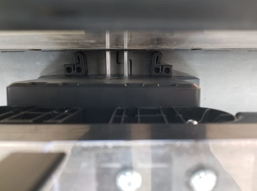

Me and my team are disagreeing about the platform because when we built it only one side of the platform was supported under the field tiles so the side away from the wall moves. Is that supposed to happen of did we miss a step while building it? I know it’s late in the season but Me and my team haven’t been to an in-person comp so I haven’t seen what it’s supposed to do.

Yeah it’s definitely not supposed to do that. The base shouldn’t even touch the wall when it’s correctly positioned and properly secured. You should make sure you have it secured to the field and in the proper spot.
where is it supported on under the tiles because we only have it on one side near the wall
It should be supported on both sides, especially the side not near the wall because that will be more prone to large movements.
The platform leg closest to the wall should be secured to the wall with standoffs. The leg farthest from the wall should be mounted to a plate under the tiles.
