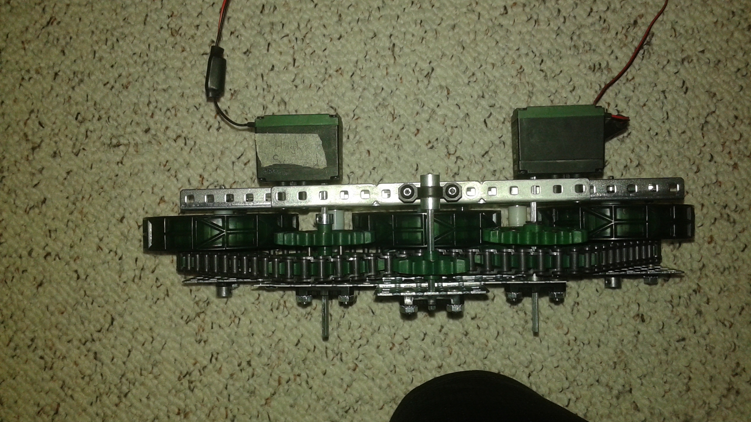

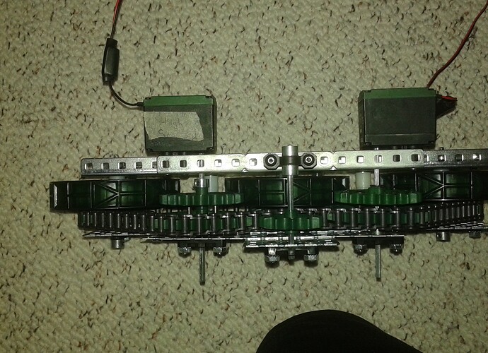

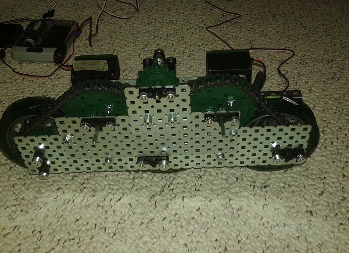

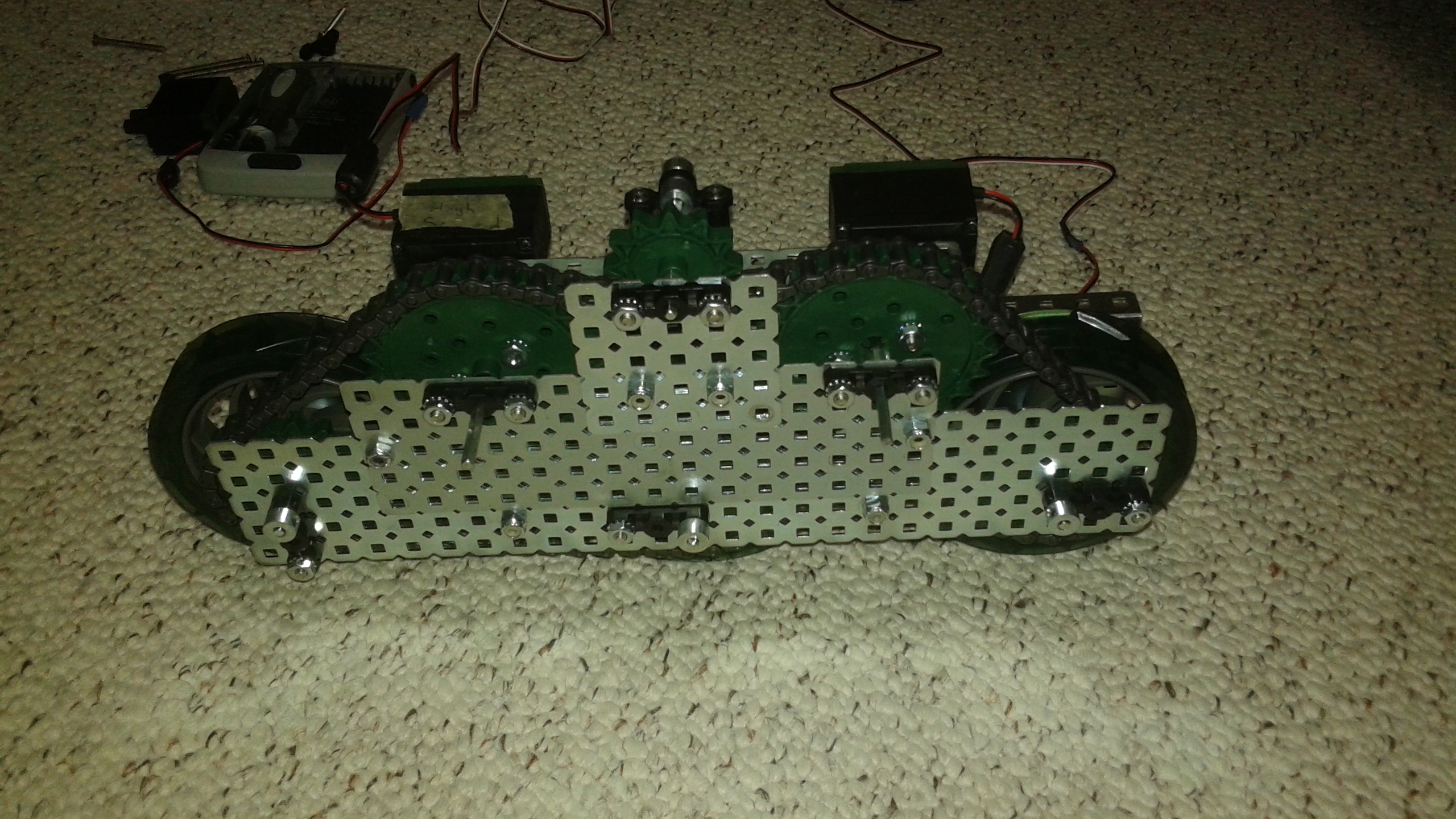

My team currently does not have access to V5 motors. As a result, we use 2 wire 393 motors, geared for high speed. However, we are having difficulties reaching the platforms. We have done extensive modifications to the drive-train. It is an all wheel drive, using chains, the wheels (when not connected to motors) spin easily and freely, and we have used grease on all moving parts. The total length is ~15". We use 2 motors per side (4 motor drive-train). We currently have the drive-train geared for high speed, using sprockets.
We are having difficulty getting up the platforms (motor sometimes can’t push forwards, and stop the cortex). We are still looking, but it seems that the only teams that are having lots of success in platforms are the V5 teams. We can add up to 4 motors (total) to the drive-train.
Please give any and all advice, especially if you have created a 393 drive-train yourself.

Do then wheels spin in place or not at all? It does seem like that ratio is a bit aggressive, but it shouldn’t stall out. I’ve made worse that still ran.
If the wheels spin, but you don’t move, it’s probably that you’re bottoming out. Do those plates you have on the drive have to be that large? Reducing the size of those could help.

I agree with this. You’re not just running 4x 393 (HS). You’ve got them going from a 30-tooth sprocket to a 24-tooth sprocket, right? (Am I seeing that right, or are they 18-tooth sprockets at the wheels? I’ll assume 24-tooth sprockets.) You’ve geared them so that your drive has (neglecting friction) only 80% of the torque 4x 393(HS) would normally provide. Yes, you’ve got it driving 25% faster, the same 200 rpm as the normal V5 motors. But you only effectively have roughly the strength of 3x 393(HS) moving the thing. Can you get two more 393(HS) in there? It looks like you could swap out that top, middle sprocket for a bigger one and stick another motor on right there. You’d have to make a little more space for it, but it looks like you have room within the structure you’ve got.
Separately, I’m questioning some of what you’ve screwed together. Several of your bearing flats don’t have two screws in them. This leaves them more likely to wiggle and let the axles hit the metal. Also, of your six nylock nuts, I only see one where the screw is clearly into the nylon. Are the other five screws into the nylon? If not, the nylock nut isn’t functioning as a lock nut. If you can’t get a screw into the nylon, you’re better off going with a keps nut. I prefer the nylocks and the keps nuts where you have used them, but I use slightly longer screws with the nylocks.

We are operating from home currently, so parts are kind of short at the moment. However, I checked, and the bearing flats are secure. Additionally, the nylon touches the screws in the nylocks (picture is deceiving)
You are right, it is an issue with torque. A 1:1 ratio with 2 motors did not work well, but when we geared the drive-train for high torque, the drive-train was able to mount the platform. Ultimately, I think we will do a 1:1 ratio, with 4 motors per side. This is easily the most flexible design I have done, and changes generally do not exceed 5 minutes.
