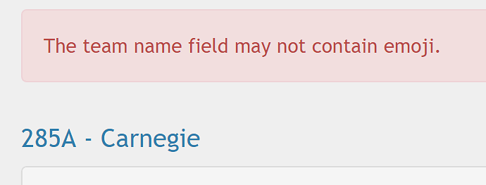

For example, money, time, energy, and resources were spent on creating UI and code for the RobotEvents sign up wizard so it did not allow emoji. More money, time, energy, and resources were spent at worlds to deal with those emojis in 2015-16. What if those resources were spent on actually addressing the core problems? For example, you said a big problem was the CSV conversion of emoji that excel can’t handle? Well, why not use those resources to redevelop code within the robotevents csv generation engine that excludes emojis, bypassing any of those issues in the first place? And the same should be done for any similar issues.
