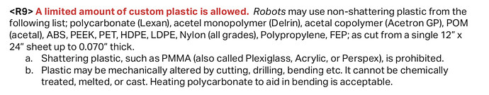

I don’t know about the rationale, but let’s be clear that Plexiglass is an illegal plastic. Polycarbonate and other non-shattering plastics are legal, according to the list of legal plastics in the manual.

Plexiglass is a shattering plastic. There is a limit of exactly 0 square inches of plexiglass allowed on your robot, for a variety of reasons besides just danger.
The most commonly used non-shattering thermoplastic in vex is polycarbonate (brand names lexan, makrolon, etc.).
You can use any from a list of allowed non-shattering thermoplastics (Manual, R9), and the most significant reason they are limited to 12x24" in my opinion is that an unlimited amount could lead to custom polycarbonate parts being sold, which would be quite strange and unwieldy for this competition. Remember, by allowing an unlimited amount of sheet thermoplastic, you would be allowing essentially a raw material in unlimited capacity, which can lead to a whole line of possible products and services (think gears, etc. that are not even custom-made for vex) being legal for use–not a great move. The reason this is not such a possibility right now is because it would be difficult to sell a product that people are inherently limited to use. I remember a few years back when someone was selling a small number of laser-cut polycarbonate C-Channels; rest assured, they weren’t so successful.

Assuming you use a full-length c-channel (35 holes) and go 14 holes wide (7 inches across counting the holes that’ll be mounted to the tray “rails”) (the comfortable sizing for a tray intake), the area comes out to be 119.52 square inches. Multiply that by 3 and you get 367.5 square inches. ( 17.5 in (full length c-channel) * 7 in (14 long c channel) * 3 (three stages)). According to rule the legal amount is 288 square inches (12in x 24 in).
So yes, it is over the limit assuming they used those dimensions which I believe to be reasonable. A cube is 5.5 inches across therefore this design leaves you with 12 holes to work with or 6 inches, essentially .25 an inch on either side of the cube in an ideal scenario. Correct me if I’m wrong.
