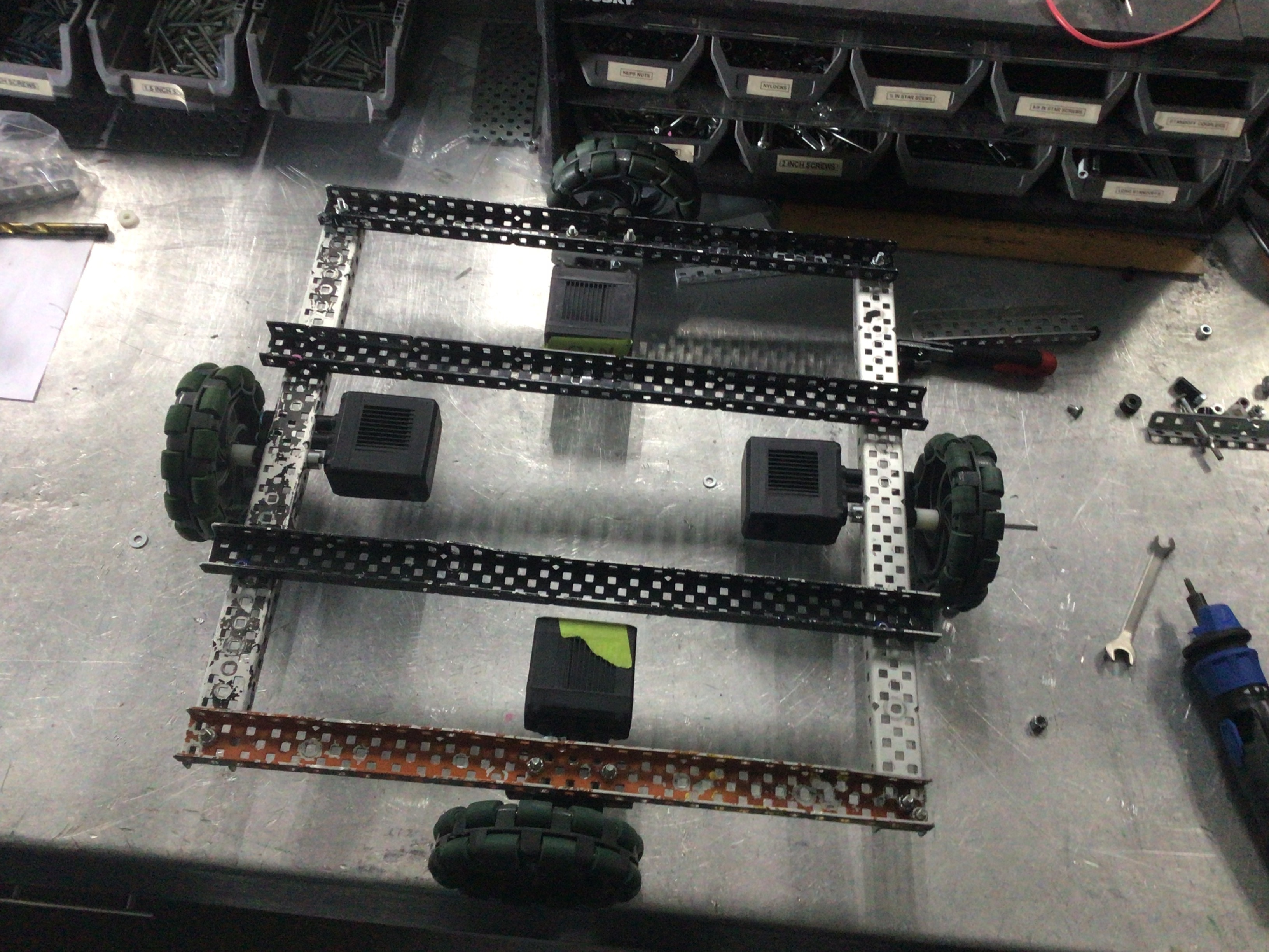

We built a prototype of what we’re calling Jesus drive. It’s literally just X drive but like tank drive too. Idk. My team leader said that this is just X drive if you orient it differently, but I disagree. Why has no one thought of this before, as far as I can read on the forums?
that is literally just a bad x drive

I made this for testing before I had gussets. I would recommend you don’t connect all four ends of the square, because making the chassis so rigid doesn’t allow wheels to contact the floor properly. Some flex in the chassis is good to make sure all wheels touch.
Once I had 3D printer time I just printed gussets (until vex ships real ones) and made a regular X-Drive.

It is not viable also if you look at some of Kepler electronics ideas his ones from ITZ he had a robot that used that drive. He called it a " crappy holonomic drive" its just not good.

I agree with your team leader, and I’m curious why you disagree. You have four wheels separately powered by four motors all a right angles to each other in the shape of a square. Definition of X-drive.
In order to benefit from all 4 motors when driving in any direction other than diagonally, your robot would have to be built such that the corner of your chassis is the front of the robot, and that’s just making the job harder for no reason. Otherwise, forward/backward driving as well as any strafing only uses two motors at a time, so that’s not a viable option either.
well, I’d say 45 degree angle wheels in corners would be a better representation, because that’s what we actually want to build. I was saying “why make a completely different thing when you could just make the real one”

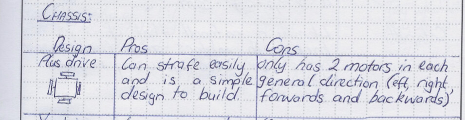

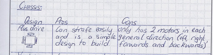

It’s actually called a plus drive:
(Taken from 2915A’s World Championship Excellence Award winning engineering notebook).
Please don’t use this drivetrain. If you want the ability to strafe, just use a mecanum or x-drive. And please, for the live of god, stop making up new names for things, before @meng comes and smites you.
