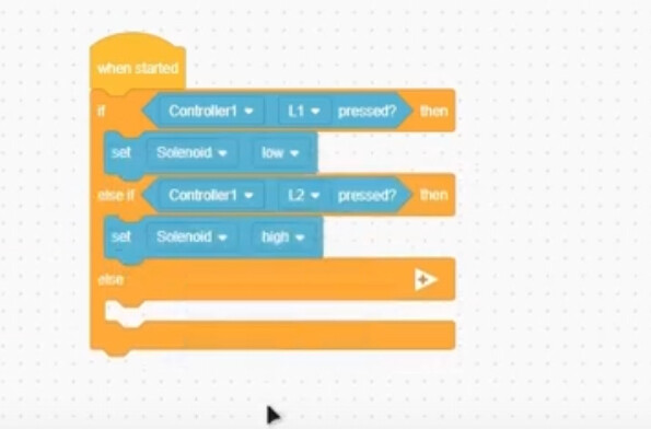

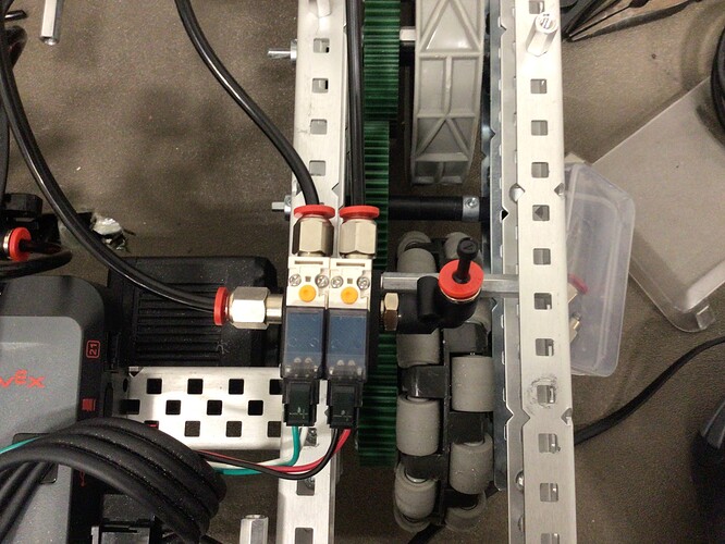

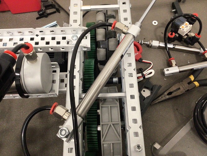

My team is only a year old and we are just experimenting using pneumatics. This year our bot has the “wings” prominent with many bots this season. I tested our pneumatic system today by pressing the buttons on the cylinder’s solenoid, and it worked great. Then, whenever I try to use the program, where I coded the cylinders to a button, it doesn’t move at all. I attached photos of the layout if it helps, as well as the code. I listed the cylinder as a 3 Wire- Digital Out in the device section.

Your “If” statement will only run once, and very quickly, put it inside a forever loop.

    • In your code, you’ll need to control the solenoids to manage the airflow to the pneumatic cylinders. Typically, you’ll use functions or commands to open and close the solenoids. For example, you might use a command like startMotor(port) to open the solenoid and stopMotor(port) to close it.
    // Example code to control a solenoid
    vex::controller Controller = vex::controller();
    vex::digital_out Solenoid = vex::digital_out(Brain.ThreeWirePort.A);
    int main() {
        while (true) {
            if (Controller.ButtonA.pressing()) {
                Solenoid.set(true);  // Open the solenoid
            } else {
                Solenoid.set(false);  // Close the solenoid
