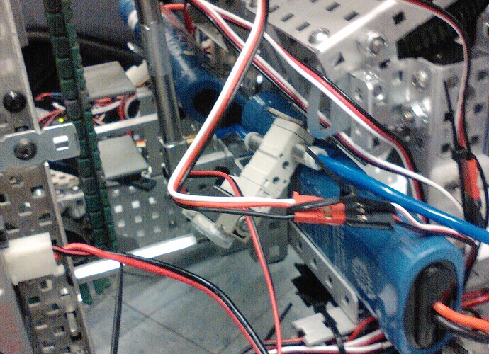

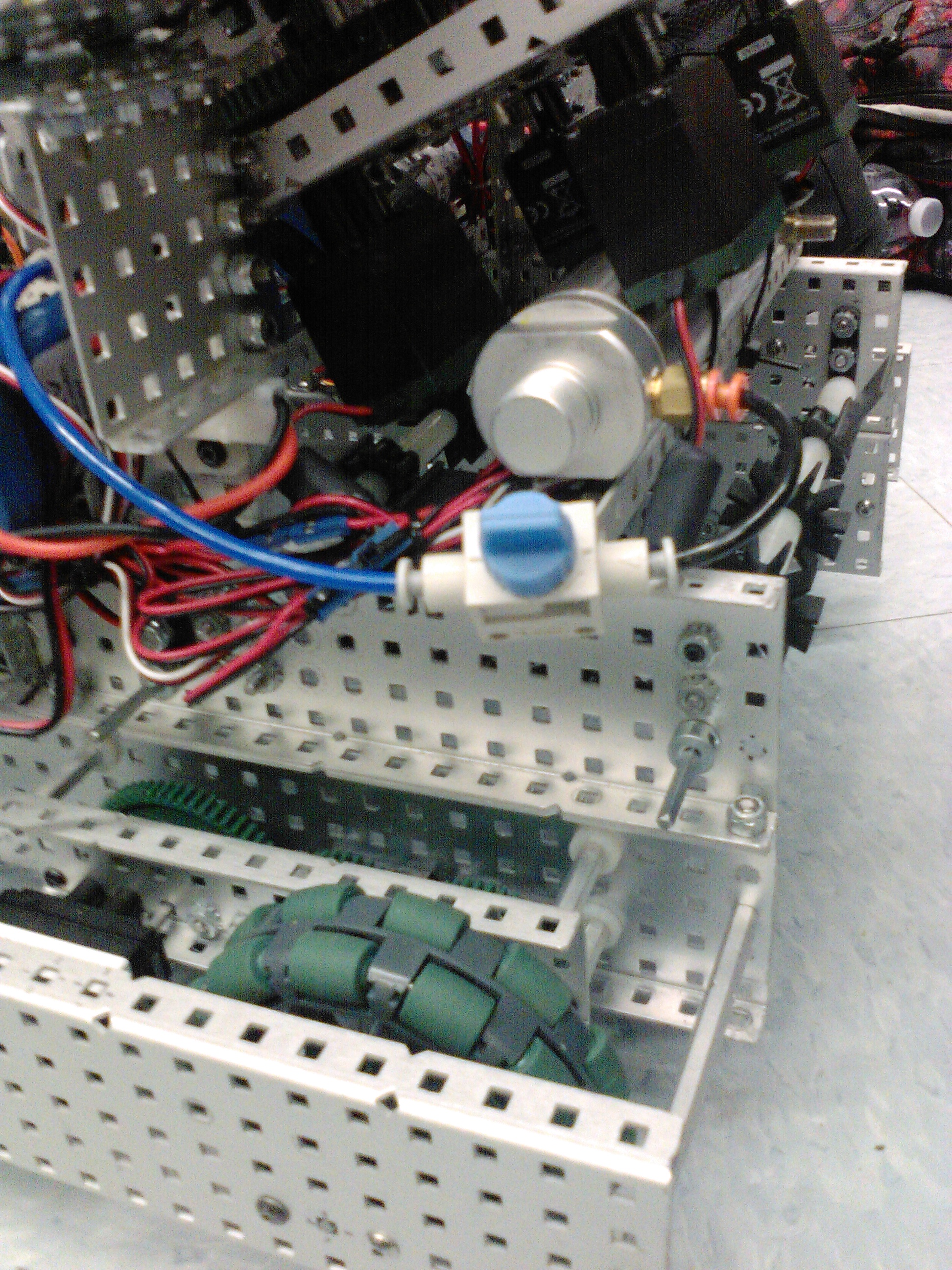

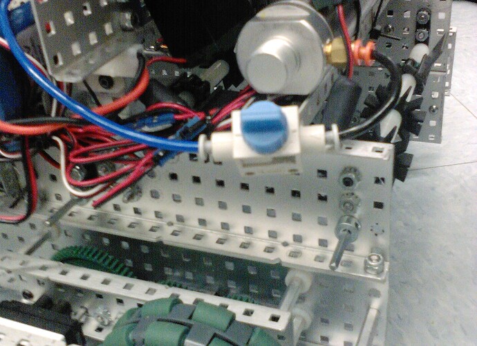

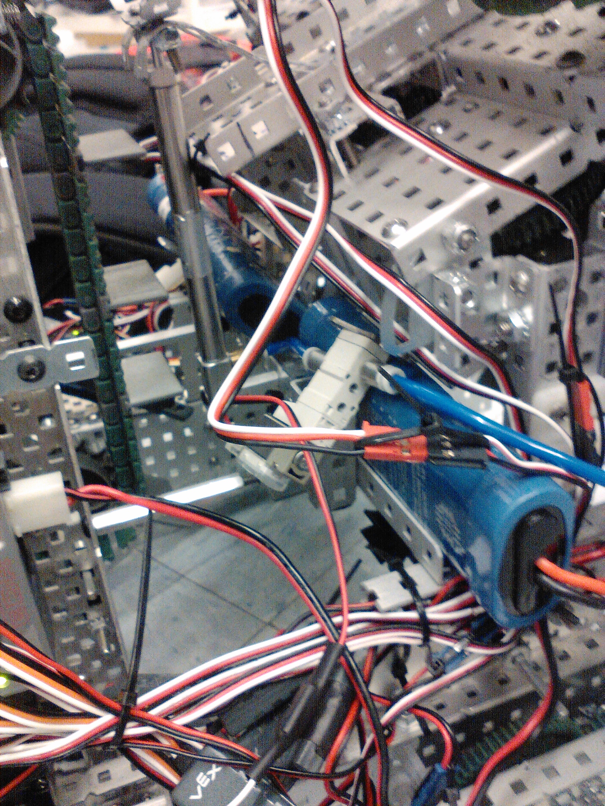

Here are the picture you have asked for
As far as I can see it looks good, but a few things to check, these things may seem obvious but sometimes it is good to check. Make sure the orange plug is in the other side of the pneumatics tank (I am guessing this is not the problem), make sure the 3 wire cable is plugged in the right direction to the brain, make sure it is plugged into a digital port, and in the program make sure it is set up as a “digitalOut”. If you have all these correct and your setup is definitely like the picture I showed, then it is most likely a disconnecting wire where it plugs into the actuator, wiggle it around to while pressing the button.
Ok well my team will try this and if it does not work I will reply on here to tell you what happens. :slight_smile:
