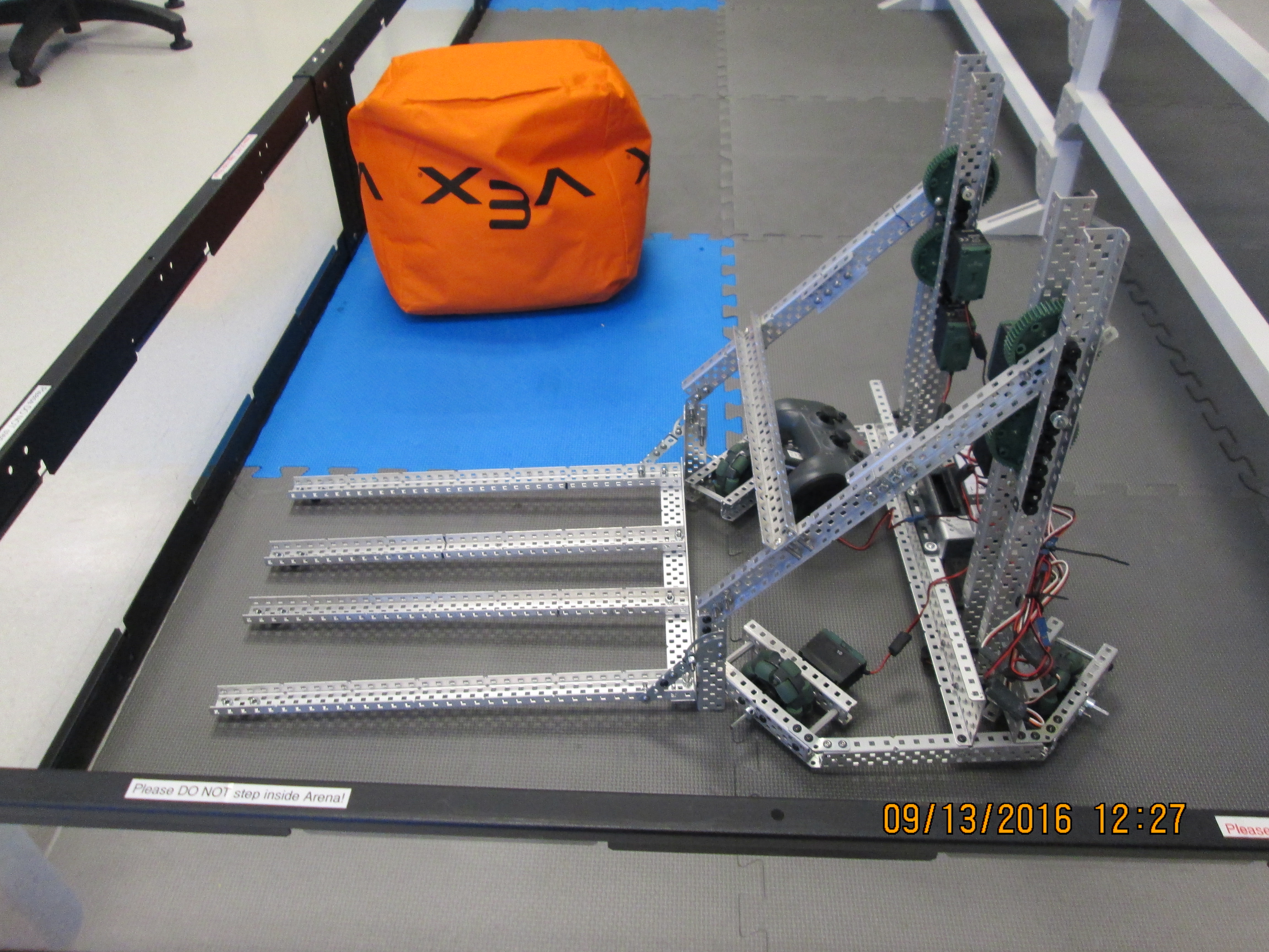

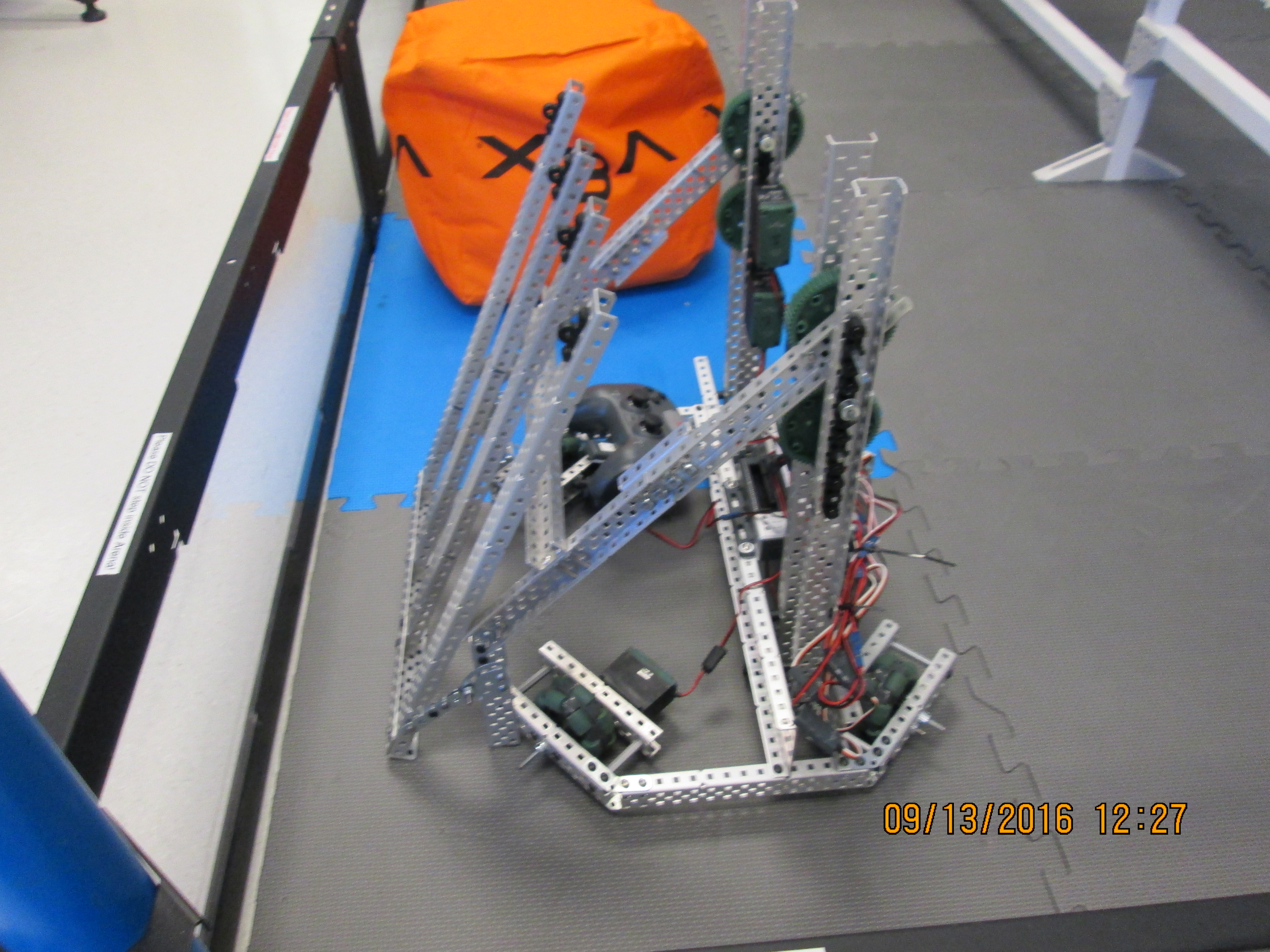

We just got back from winning a tournament and now we are going to prepare for nationals. However we need to add a launcher to our robot. We all agreed on using pneumatics for our launcher and are going to start prototyping on monday.
**Before anyone goes and tells us that pneumatics are not the best for a launcher, I would like to point out the following:
Our robot can score with a forklift in the far zone
our robot can high hang
we have a holonomic drive that allows us to strafe.
And all of this uses exactly 10 motors. We will be using the pneumatic launcher on our forklift as a secondary scoring method. The two middle bars on the forklift will be where the launch bars go, and in the space between the front wheels we will put two air reservoirs.
I’ve included some old photos of our robot for reference. However they don’t show our hanging bar attached to the robot.

I see 8 motors in the picture. Where are the other 2? I agree with @lacsap about optimization. If your lift is slow, add 2 motors to that. If your drive is slow add 2 motors and use a higher ratio. I could be wrong, but I think using pneumatics on a lift will require multiple pistons on full pressure, which will drain your tanks fairly fast as you will need to be scoring constantly.
What I think you should do is try a launcher-dumper hybrid, where you can both launch and dump using about 6-8 motors, rather than 4 motor dumper and pneumatic launcher. But if you were going towards a 4 motor dumper and pneumatic launcher, I think you should actually have a 4 motor dumper and a 4 motor launcher (Since you can have a total of 12 motors w/o pneumatics).
the pictures are kinda old. The two missing motors go on the hanging lift in the left rear corner.
From the timestamp of the picture, it is from 6 weeks ago, so expect some changes. Moreover, the fence appears to be in the wrong location - making far throws to the perimeter wall easier :slight_smile: (I am assuming the fence is in their for decoration).
I highly recommend teams to take pictures of every iteration of their designs. I like seeing the design evolution through sketches, pictures etc. The picture having a timestamp in the image establishes a date. Good practice.

I don’t have access to all of the photos but I took these ones myself. Our current robot is much more sophisticated now.
I figured as much. Take lots of pictures for your notebook. Good luck! Hope to see your team at Massachusetts events.
