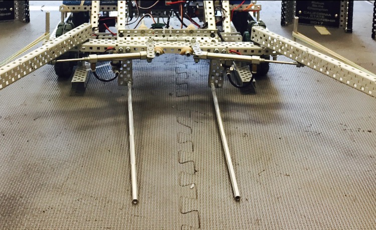

The further from the fulcrum (claw hinge) they are, the better as this gives them more torque. Also, the closer they are to a right angle with the claw the better (this also supplies more torque)
Do you have a picture or a diagram we can see?

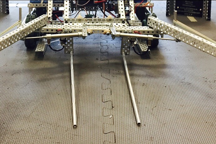

Below is a picture of our claw and piston placement:
We had our pistons almost literally horizontal. In addition, we had it with two regulators covered in electrical tape. How the solenoid works is it opens the tube for a set amount of time. So more tubing is wasted percentages of air.
