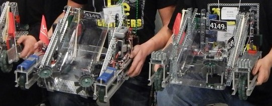

This picture is terrible, it was the only one I could find and I had to zoom in and crop it.
But…on the left, we had a robot that used the batteries as counterweight. (we had a power expander). On the right, we used a small piece of plate metal, and put a ton of long screws through it from the bottom, then filled the screws up with nuts. Quite heavy.
Of course, this is not ideal, your robot SHOULD have a well placed center of gravity so that unnecessary weight is not needed. Extra weight only makes your drive work harder.
