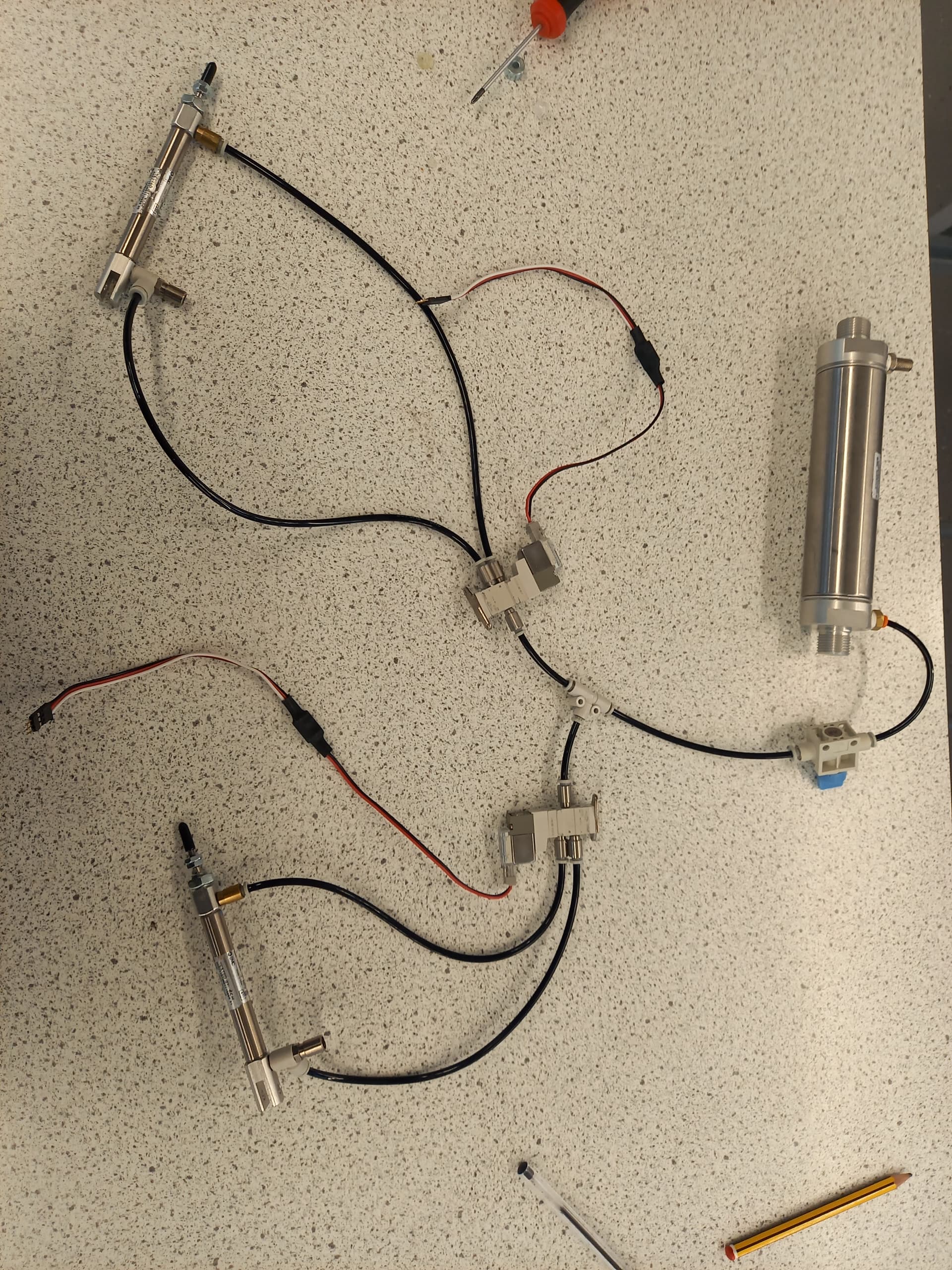

What exactly isn’t working? Could you share a picture of the pneumatic setup and a copy of the code, please?

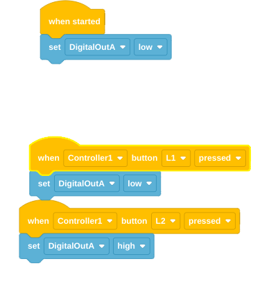

Dont have my coder with me rn. They coded it exactly like it said in the links sent above. Plugged in the wires to 3 wire port a and b on the brain (havent connected wings as want to get pistons working beforehand)
Screenshot 2024-02-21 11.54.50 AM
Here is a simple example of the code.
Why don’t you just use two t-connectors instead? I’ll send a picture of how we have ours set up if that helps?
The basic plumbing looks ok. Be sure to open the exhaust flow control valves on your air cylinders all the way. The wont affect the extension of your air cylinders, but could keep your air cylinders from retracting if they’re closed all the way.
Once your air cylinders are extending and retracting, you can experiment with slowing down the retracting of your air cylinders.
Ok thanks. Ill try this. When i tried, they wouldnt move at all but am working on getting support from a team in our neighbouring school. Thank you so so much for your help guys, literally a godsend!
