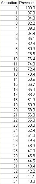

There is some confusion on my team about how many FULL strength actuations can you get with one piston and cylinder?
someone answered 40ish but that number doesn’t match the math my teammate has done so can anyone else agree with this number
That makes sense… Between the Solenoid and the Piston, all the Air gets vented, the shorter the distance, the less Air removed from the Reservoir…
You can get 0 “full strength actuations” with one cylinder and one reservoir.
The instant the solenoid opens and air goes into the cylinder, the pressure is dropping, so when the piston is fully extended you no longer have the pressure in the system that you started with.
Pressure is inversely proportional to volume, so as volume increases, pressure decreases.
The change in volume of the inside of a cylinder is .242in^3 per stroke. There is space in the rear of the cylinder, space in the fittings, and space in the tubing which all cause losses, so let’s just say each time you fire a piston, the volume of the system increases by 0.25in^3.
The volume of a reservoir is 9.153in^3. Let’s just say it’s 9.15in^3 because no one cares about 3 thousandths of a cubic inch.
That means that after each firing and subsequent retracting, the pressure has decreased to 9.15/9.4 = 97.3% of its starting value.
Now I’m going to list the volumes and pressures after each actuation (meaning after it has been fired and then retracted):
[ATTACH]6064[/ATTACH]
The 40 that you were hearing probably comes from doing the calculations without doing the rounding that I did.
Thank you that is what my teammates math also got but we havent used vex pistons and wanted to double check because we thought that the 40 at “full” power didnt make sense.
