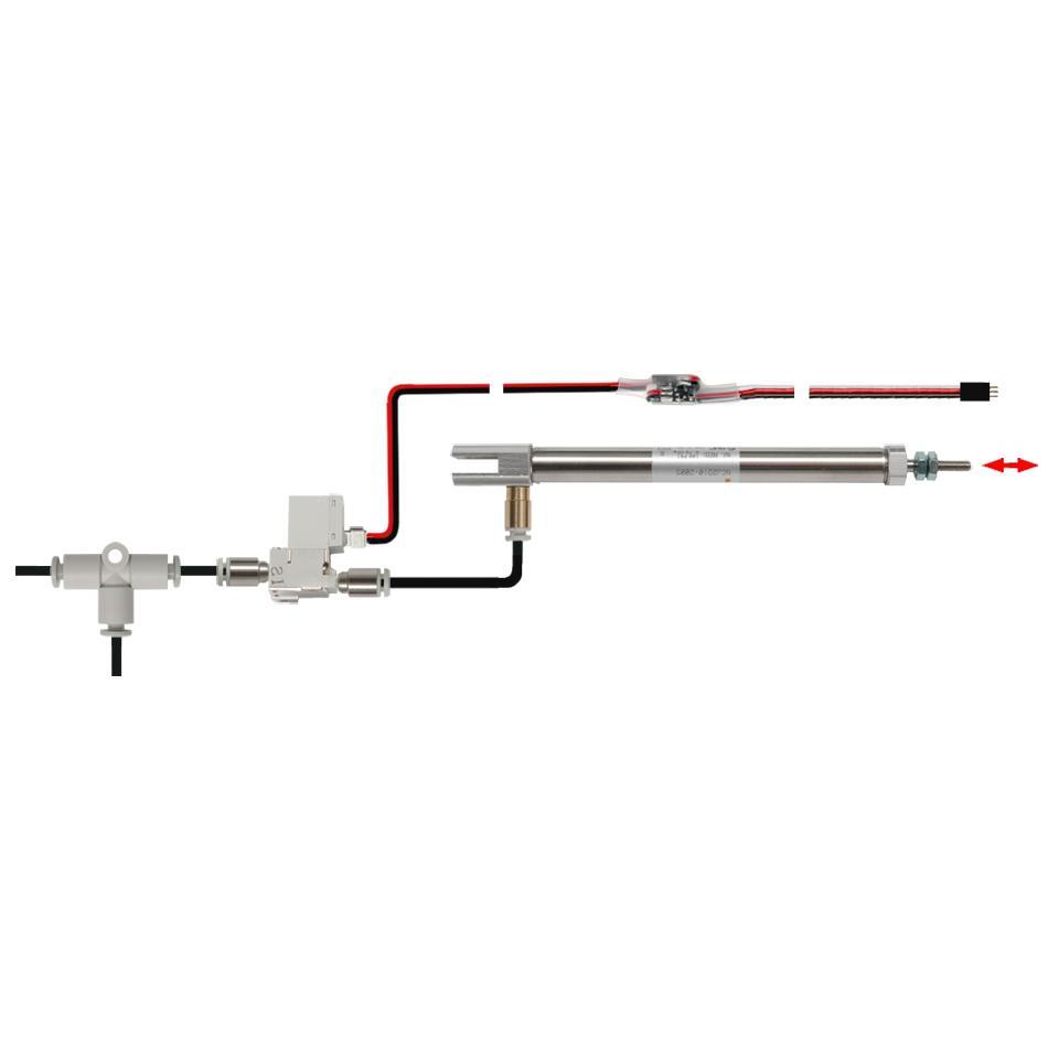

The solenoids are the motorized switch that manipulates the airflow. Make sure that the reservoir connects to the “P” of the solenoid and the “B” and “A” ports are connected to the cylinder.
If you’re using single acting, use this image for reference:
To add on, make sure that your pressure regulator allows airflow as it can restrict airflow as well.

I have taken off the pressure regulator and the cylinders are half working. When they are retracting they are exremely fast. but when I press them to go out, they are really slow. Any ideas would be useful. thank you for the input so far.
You have used exhaust flow control valves on the cylinders (which were provided from the pneumatics kit). On those valves, you’ll find a little adjustment screw, which adjusts how fast the cylinder moves in that direction. Loosen the screw, and they will get full flow. Probably best to replace the exhaust flow control valves with normal fittings (you can buy just the fittings from Robotmesh.com)
