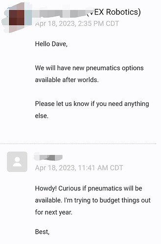

I got this response back today. I think I’ll hold out for the next month and see what happens.
