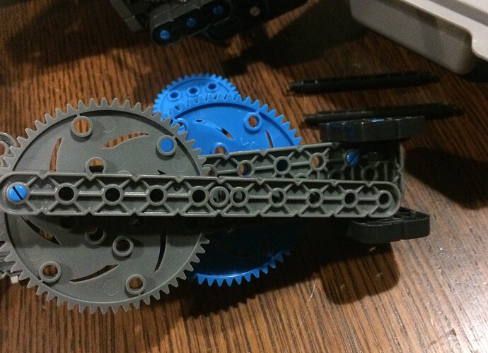

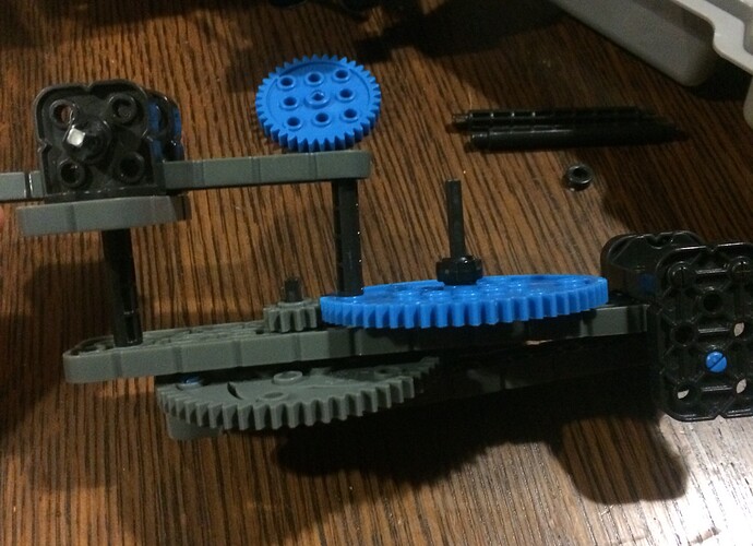

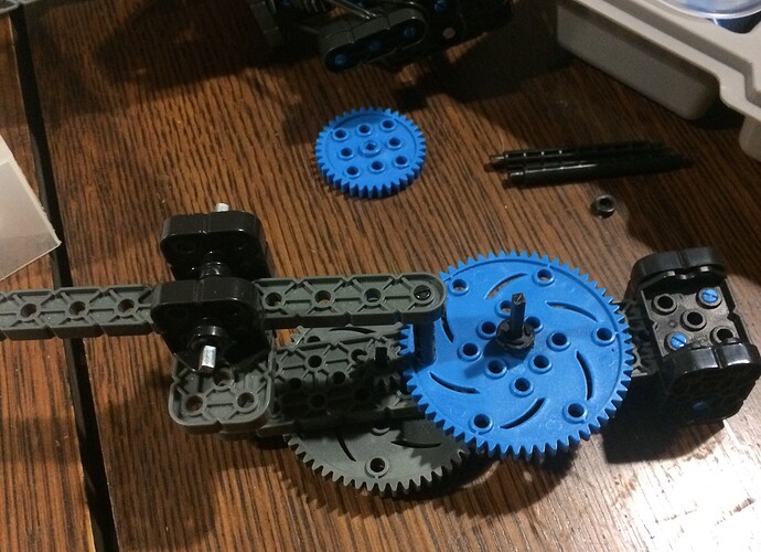

Okay, the only linkage I could come up with. I modeled it with IQ pieces, but you get the point. It would take up about 1.7x the amount of space you currently have in the arm, I think.
I spaced stuff out more than necessary for clarity.
The first two pictures are of the side with the pneumatic cylinder. That’s the thing I encased with the black pieces. The last one is of the side with the striker. I’m sure someone else can probably improve on this, but it’s all I’ve got right now.

What I built is big and bulky. I’m not sure if you have the space for it, but it would ideally go inside of your angling arm. That linkage, in equivalents, will multiply your speed by 7. But I don’t think you can adjust the speed of the pneumatic cylinder. Don’t add what I built yet and let’s try to get the code and wiring figured out. I’ve never played with pneumatics, (as you know) so I might not be that huge of a help.
