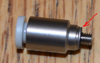

Does anyone know how to fix leaking actuators? We have been trying the tape that comes with the kit but that isn’t working. I was going to us hot glue until I remembered the rule about no glue. Any recommendation?
The fittings on the air cylinders should have a small sealing washer. Don’t use teflon tape on these threads as it interferes with the seal washer. Take the fitting of, clean any foreign material, and reassemble, making sure the little washer is in place. Finger tighten, then tighten with a hex-key wrench (if the fitting has an internal hex recess (no every fitting does)), or carefully tighten with some pliers, but not too tight.

If the cylinders are leaking around the fittings, make sure the small gasket / o-ring is not damaged. It should go between the fitting and the cylinder. They should also be snug (very slightly beyond ‘finger tight’). Do not use tape on cylinder fittings.
