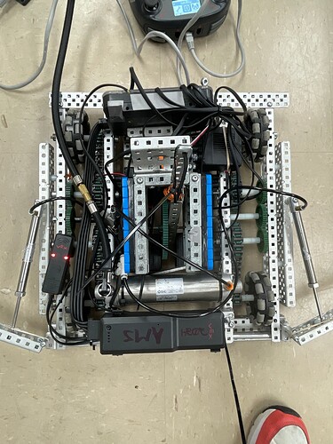

Can you please give a diagram or picture of how you have your pneumatic system plumbed? Where is the air coming out? Can you post a video?
Here’s an image.
Correct me if I’m wrong, but it looks like your solenoid is plugged into the wrong side.
I will go ask my team members

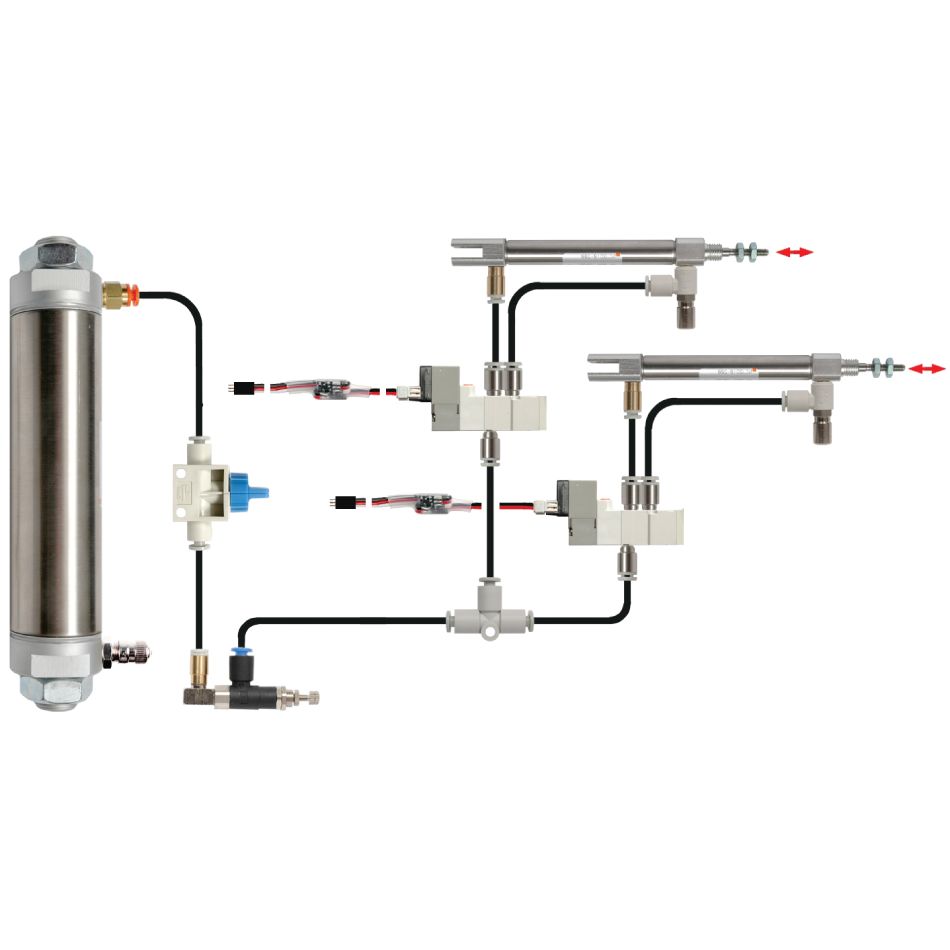

One way cylinder setup example. FYI.
This is an example for single acting:
