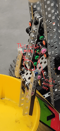

When building the locking clamp design I ran into the same problem with it not releasing the way I fixed it was to add a bumper where the top c channel of the build collides with the bottom making the clamp not go so far it will lock the pneumatic from releasing
This picture was before I added the bumper but I can’t get a photo of the recent build as of now
Then again you might have a pneumatic problem and not a problem with the build at all but I hope this helps
Ok. If you are able to get a new picture that would be helpful, but thank you for the tips.
A simple bumper like this should help the claw going too far it would lock itself from releasing it worked on our robot could possibly work on yours
Ok. Thank you. That was not the specific issue I do not think,but that will still help. Thank you

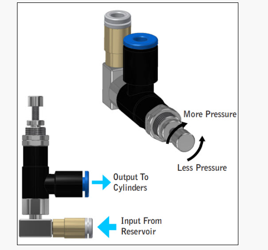

Do you have any pressure regulators connected to your system? We had a similar issue with our tilter and it turned out that our regulators were over-tuned
what do you mean? What are pressure regulators? We might have one on there, but I am not the one who messes with the pneumatics. That would be the builder on my team, owen.
I know what they are as I just looked them up now. Are those needed for 1 single action pneumatic Piston?
No they are not needed, but generally encouraged so that you can get the most uses out of your clamp. However, I would try running your clamp without them just to check if that is the issue.
Here is an image just in case you were unsure what I meant by pressure regulator
Thank you so much. That could be the issue. I will check at practice today.
