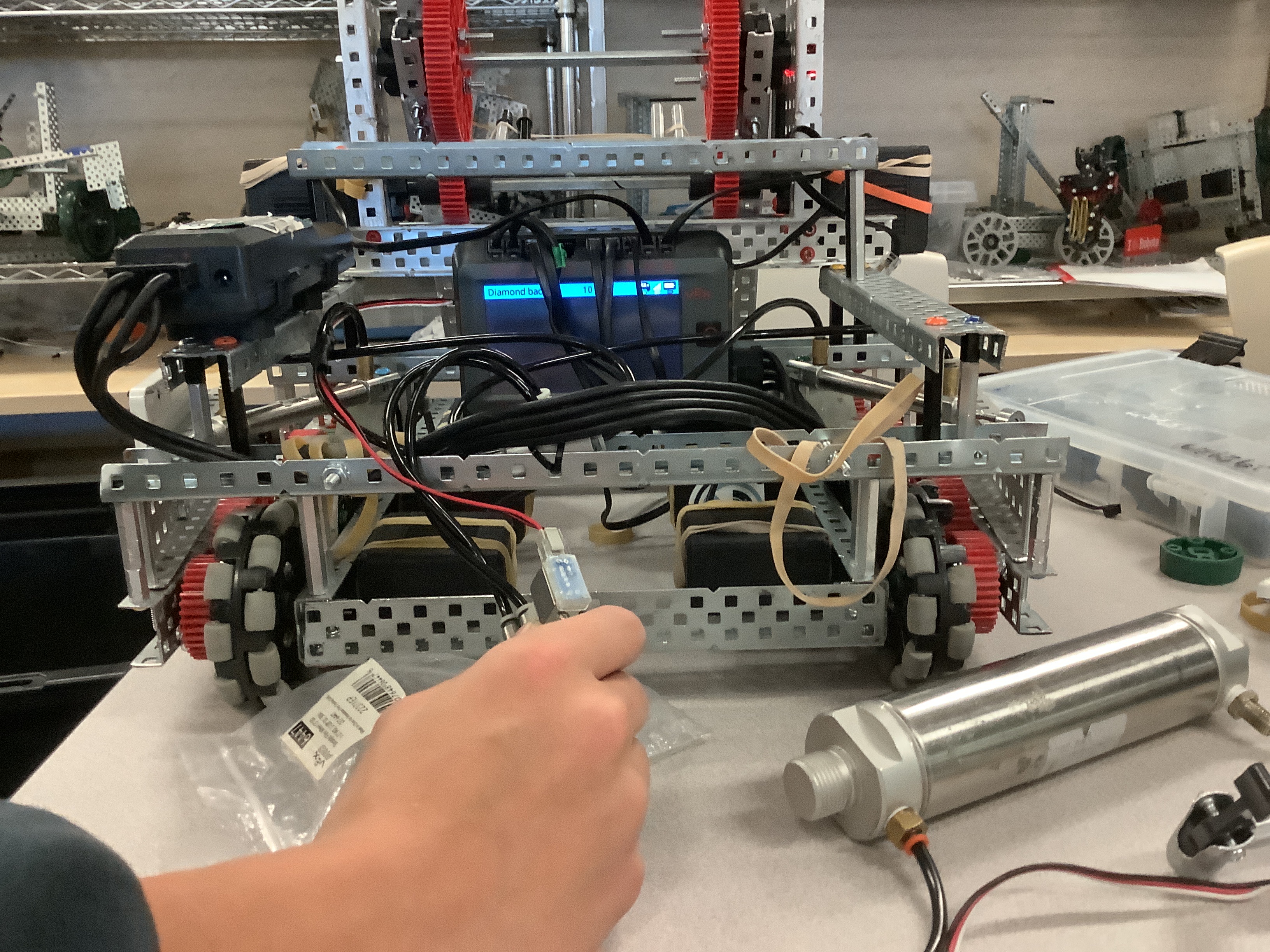

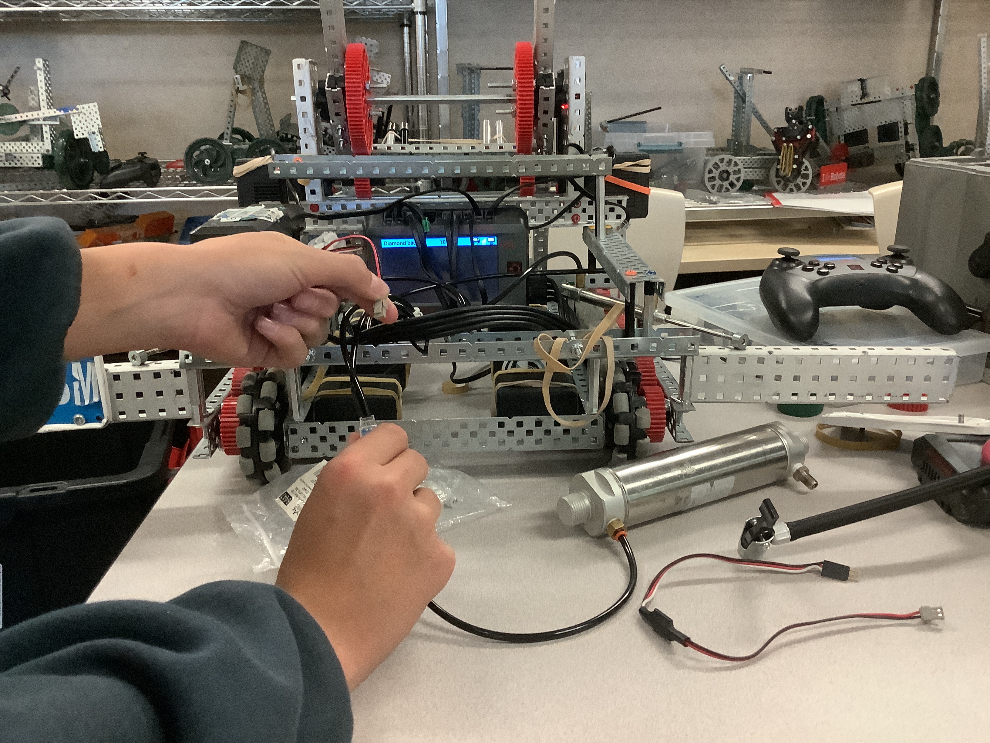

Hello VEX community, I am having trouble with my Pneumatics kit on our robot. My team has the older pneumatics kit and it was working just fine the night before the Windsor tournament. Nobody has touched anything on our robot until I messed with it today. I have swapped the pipes, brain, controller, digital out cable, and the solenoid. We have also changed the code many times and nothing has worked. When the brain or the cable is disconnected it will open, but when connected they close. We have had our coach and some of our teams try and help and nobody knows what is happening like 79298C and 79298T. Anyways thanks for trying to help me.

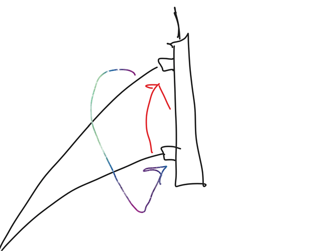

try switching the tubing. For example unplug the one on top and plug it onto the one at the bottom. Then unplug the one at the bottom and pug it onto the top
Sorry, but I don’t really understand.
The bottom tube should get moved to the top. The top tube should get moved to the bottom.
Oh I understand now. But I have already tried doing that and it just swapped if it opens or closes when the brain turns off. Thanks for trying to help though.

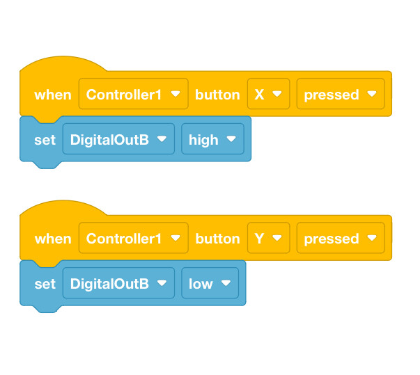

It’s (When controller1 X pressed. Set DigitalOut B high.) and (When controller1 Y pressed. Set DigitalOut B low).
I made this code right now because I accidentally reset the old code. So this might not be 100% accurate.
Wow, that is really weird that your pneumatics aren’t working because that code is fine. I have two other ideas to help one is that the solenoid is plugged into the wrong port which I have done many times. Another idea that goes along with it is to program it to different ports or change the solenoid driver cable itself. One final thing that might be worth it is to try to test the setup you have with another brain and see if that could somehow be the issue.

We were using a 2023 brain with a new update and it didn’t work then we switched to a 2019 brain and it worked
You need to switch the fittings around on your solenoid, the robot automatically starts with them in the “low” mode, if your fitting is incorrectly placed in the “high” mode, it will extend. Switch your fittings on the solenoid!
