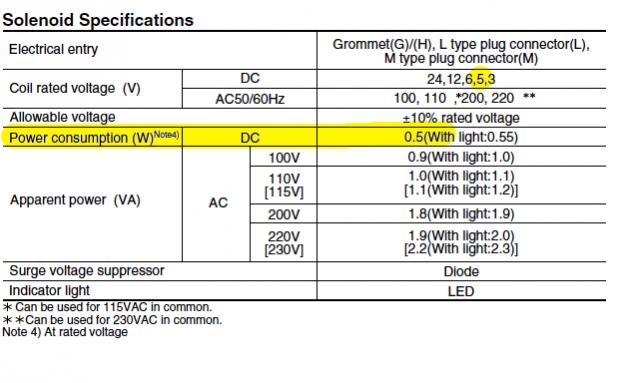

I should add, if you really have 9 solenoids, you are close to the limit for the 5V power supply. The solenoid spec is as follows.
[ATTACH]7369[/ATTACH]
The power consumption is 0.5W, so about 100mA of current. 9 Solenoids gives 900mA, the 5V regulator is rated at 1A so not much headroom there. You are still within spec but I just wanted to point this out.
