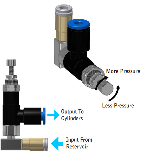

There is a flow limiter valve that is included in the pneumatic kits. It limits how much air, and hence psi, is used for each actuation.
Another thing you can do is not to use any air when putting your lift down, letting gravity do the work. Check out this topic:
