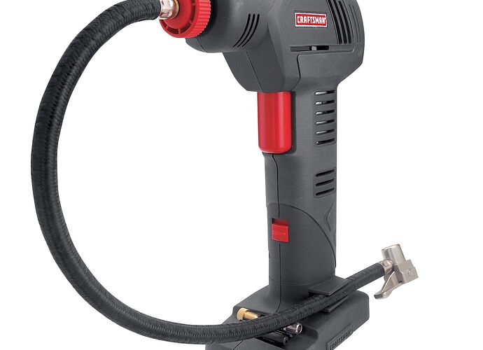

Oh, ok. And you can just use a bike pump to fill it, or do you need some kind of adapter.
You can use a bike pump, but that would eventually wear you out.
We use a motorized drill-looking pump, and is called “Craftsmen Cordless Inflator”
You can program it to a certain PSI and just hold the trigger… The pump will automatically stop at the desired PSI.
[AVG Cost for one: $70]
