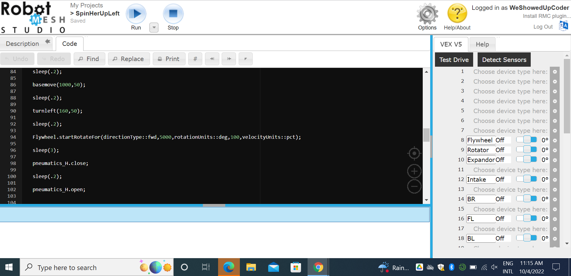

I dont know how to program pnuematics to work normally in the C++ auton mode, it moves forward but then it doesn’t move back. This is what I have that does that. Pls help!!!
pneumatics_H.close;
sleep(.2);
pneumatics_H.open;

What platform are you using to code?
To use pneumatics, use one of the following:
For VexCode:
pneumatics_H.set(true)
(or false)
For PROS:
pneumatics_H.set_value(true)
(or false)
pneumatics_H.close()
is used to set the solenoid to the closed state.
I would recommend checking out the VexCode or PROS API.

This is the format i use
Thanks, this will really Help
