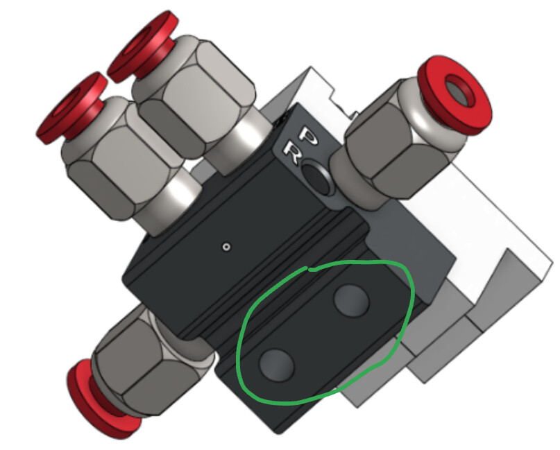

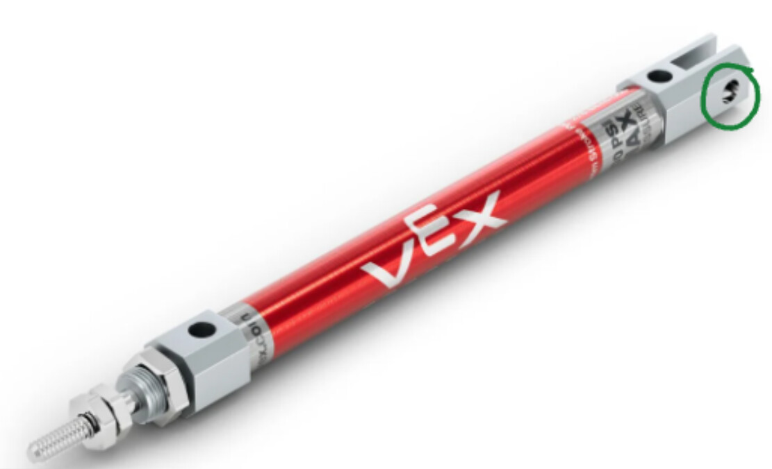

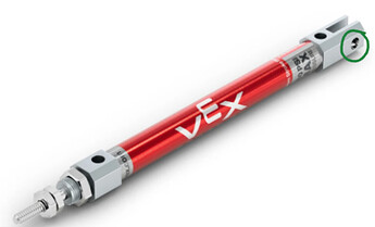

Tanks, fittings, regulators, etc - usually just zip tied somewhere
Actuators - using a screw through this hole:
Pneumatic solenoids (the new ones): using a screw through this hole
