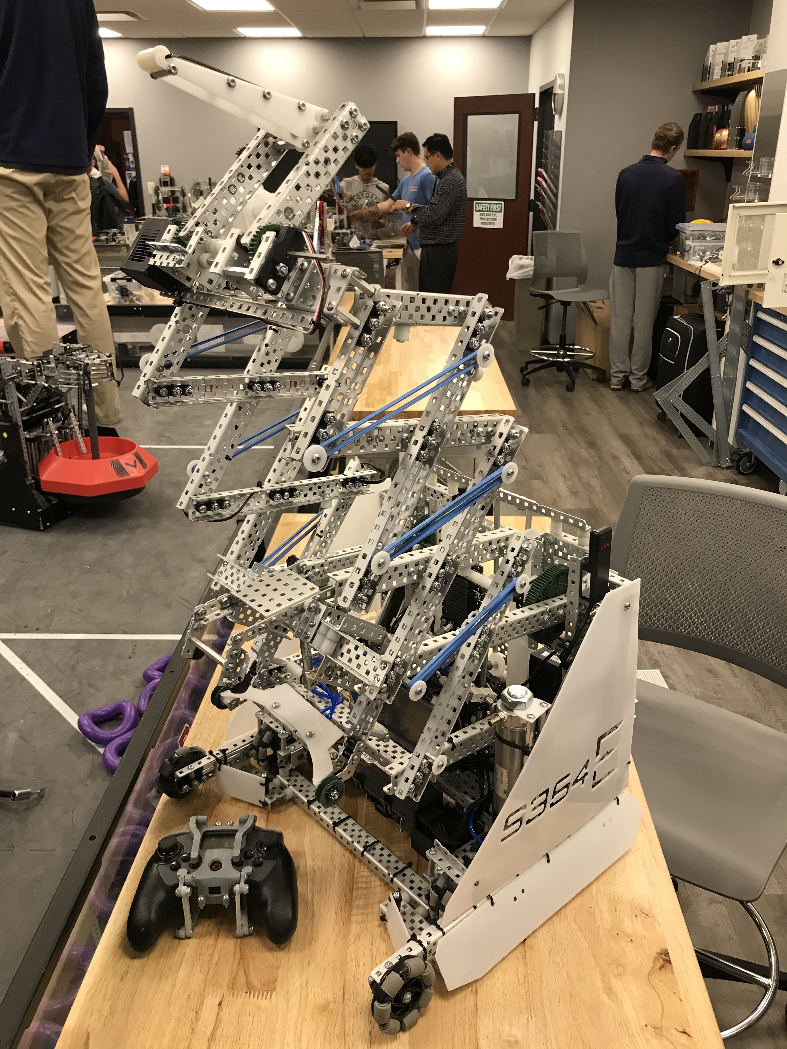

There are legitimate arguments that it can be interpreted differently, but this has been the ruling at most signature events and will likely be the ruling at worlds. Though I wasn’t able to be there, my team was asked to take off our large decorational side plates at the WPI signature event due to this ruling:
(to clear up any confusion, these plates provided negligible structural support as they were mounted by zipties and one screw, and were not intended to hide or protect any sort of mechanism behind them. I used this robot at several events and signature events without any sort of protection in that area, and nothing was ever damaged. They were also separate from the side skirts and weren’t involved in their functionality either. Also, “functionality” is defined as “…do not affect robot performance in any significant way or affect the outcome of the match” (first sentence in R13, emphasis mine). It also says inspectors have the final say in this matter, but it’s implied they are supposed to abide by this logic).
If i had backed these plates prior to the event with perhaps flat plate or even mesh, they would have been legal.
however, things like ziptie-ing stuffed animals to robots is totally legal, and so going by this logic, you could theoretically use non-shattering plastic that is slightly thicker than what is legal, mount it on your robot, and as long as you are able to prove it is nonfunctional, it wont count towards this limit, regardless of if it’s backed or not. I know it seems weird, but it’s how it’s being ruled.

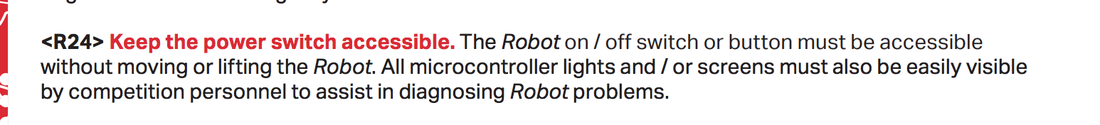

ours are simuler to those ones but do cover our brain and wires on one side
Is the V5 brain visible, keep in mind R24
ya I seen that the side plates are on hinges that can easy be moved
I think the rule means visible without having to move parts of the robot off to reveal the screen.
Bro I know that robot…
and if they do have problem we can easly take them off
It’s so the refs can see the brain screen to diagnose white screens etc., it needs to be visible as per rule R24
ya that makes since
