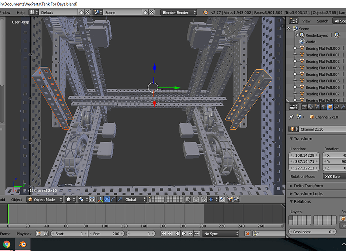

For our team’s bot, we have a 4 bar dumper design. I was thinking about using a polycarbonate box to stabilize the lift in the center. If this box had 4 sides of polycarbonate and 2 sides of C channel, would it stay rigid enough for this application?

Yeah, a picture would help. Anyway, if one sheet was bolted to the back, one to the front (4 screws each) I know the lift would still have sideways flex. On the top and bottom of the C-channel I was thinking about also using polycarbonate. (If I find an elegant way to attach it) Although I may just make the lift a bit smaller and use 2*25 in place of the top/bottom C channel. (But I would rather not, and the current spacing is just under 29 holes between the 2x10s)
I think I see what you mean now. If I understand correctly, you’re planning on using polycarbonate for an essentially “structural” purpose, to hold the sides of your lift together?
If that’s the correct interpretation, then I would firstly recommend that you just use a cut-to-size C channel. While it might seem like a bit of a hassle to get the 29 hole long piece of metal, I think it will be the easiest solution overall.
However, that isn’t to say that polycarb absolutely 100% won’t work - it can, and has. Check out 2Z from Skyrise:
They used multiple strips of polycarbonate mounted in various configurations to keep their lift together, and so if you tried something similar, you might be able to pull it off.
I hope that helps! :slight_smile:
Thanks for the thoughts! I would go for the 29 hole metal, but I am not exactly a fan of cutting metal to odd lengths. I’ll give the polycarbonate a try and if it doesn’t work, no harm done – as far as I remember it’s far cheaper than metal.
The main reason the poly has flex is its plane form. If you put folds in the sheet using a brake, it would be far more rigid.
