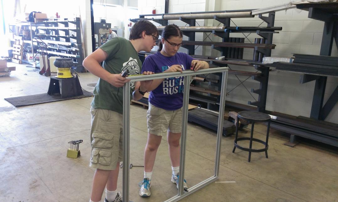

We’re building a modular field riser…nine 4’x4’ sections, made from 80/20 T-slot. Pretty pricey, but it will last forever and the kids can assemble it completely (no welding). Deck will be 1/2" OSB sheeting, four at 4’x8’ and one at 4’x4’.
In a couple weeks I’ll post a complete BOM and price list. (We’ll be having one of our students doing this in SolidWorks, so it will take a bit of time). Our 80/20 dealer gives robotics teams 40% discount on the parts.
Several of our mentors work at companies that use t-slot material all the time, and a good portion of what we needed was donated.
We have a booth each year at the Monroe County fair, so this field riser can be used in sections for exhibitions. At the fair, we’ll assemble a couple 4’x8’ fields for demonstration and public interaction. Also, were building a VEX IQ riser the same way, and it can be built as a 1/4, 1/2, or full field.

We built it mostly from 1530-lite (1.5" x 3") with 1515 (1.5" x 1.5") legs, with some 4080 metric mixed in because that’s what we could get donated from some of our mentors’ company’s maintenance shops. Not including the value of donations, we have about $1000 into these two field risers (one for VEX, one for VEXIQ). Building from wood, like a deck, would have been a lot cheaper, but no where near as long lasting or cool-looking:D
