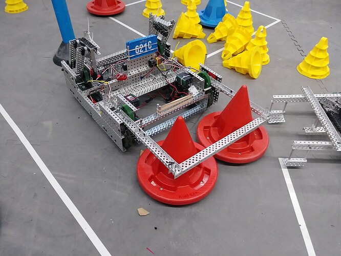

Can someone explain to me, due to utter ignorance, what a cagebot does? I have seen pics where they wrap some extension around a mogo, do they drag them as well?
Yes. So far the max capacity of a cagebot is 2 mobile goals. And the cagebot simply drag them around so that it is very difficult for the opponent to stack.

This is from the videos that i can see so far.
But realistically, most of the time it is also going to be 2 - unless the opponents are going to give up their mobile goals during auton for you to pick up… which is very unlikely.
