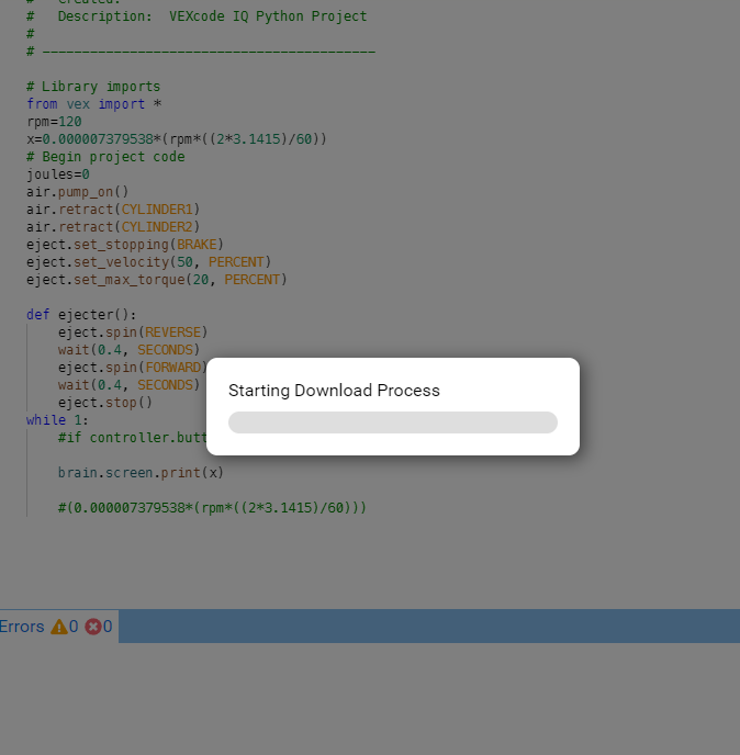

Possible Bug: Stuck on "Starting Download Process"
When I tried some Python code to my 2nd gen brain, it is stuck on “Starting Download Process.”
This have happened multiple times, Unplugging or powering off brain do not do anything. I have let it sit on this screen for at least 15 minutes, and have had no result. My 2nd gen brain and Vexcode IQ are on the latest version. I am using Windows 10 on the most recent update.
Were other programs working before ?
We are not IQ, and my team is V5; however, we have this same problem constantly, either stuck on starting the download process or downloading Python system files. Usually, we reopen the tab, and it works again.
@775Motor @cymullins
Are you downloading the projects to the Brain via the Controller?
If yes, we’ve discovered an issue where it tries to download Python files even when they aren’t required. We’re currently investigating the problem. In the meantime, please avoid using the Controller to download projects.
If not, and you experience the same issue,
Could you please submit feedback including diagnostic and usage data, and reference this post? That will help us better understand what’s happening
Several programs in the past have had this same issue, across different computers with different hardware… I am not downloading programs through the controller, and have the brain wired directly to my pc.
