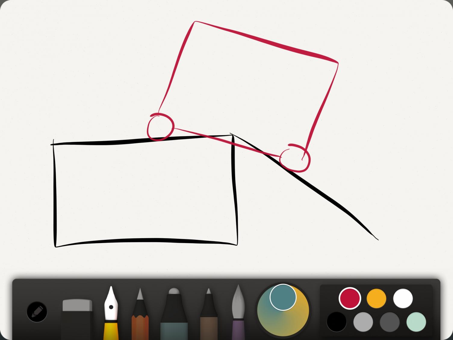

In designing a possible robot drive train, it is possible to design an open chassis, like the one shown. This would have nothing standing in the way of the wheel to any other object, particularly, an object with an incline. An open design, with the wheel, exposed on the front and sides would be the perfect solution to driving up ramps. However, I am not sure how to ensure the wheel receives enough force without the possibility of slipping gears or parts. A drive train that is able to support the weight of another robot and launcher is very important, but the base on which the robot is built is equally as significant. A design that would enable a robot to climb at an incline would allow for the situation of both lifting another robot, and being lifted yourself.

Since most ramps will have a 45° angle at the top, either the middle of the chassis will have to be slightly raised so that both wheels will be touching the ramp at all times or there will have to be a third set of wheels in the middle of the chassis.
Does the middle matter if the front wheels are already on the ramp? Wouldn’t the angle of the wheels prevent the middle from hitting the ramp? There would need to be an open design for the back as well to help in existing the ramp.

I was referring to when the robot is at the top of the ramp, not the bottom. Here is a drawing showing what i am referring to.
