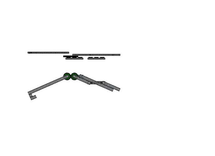

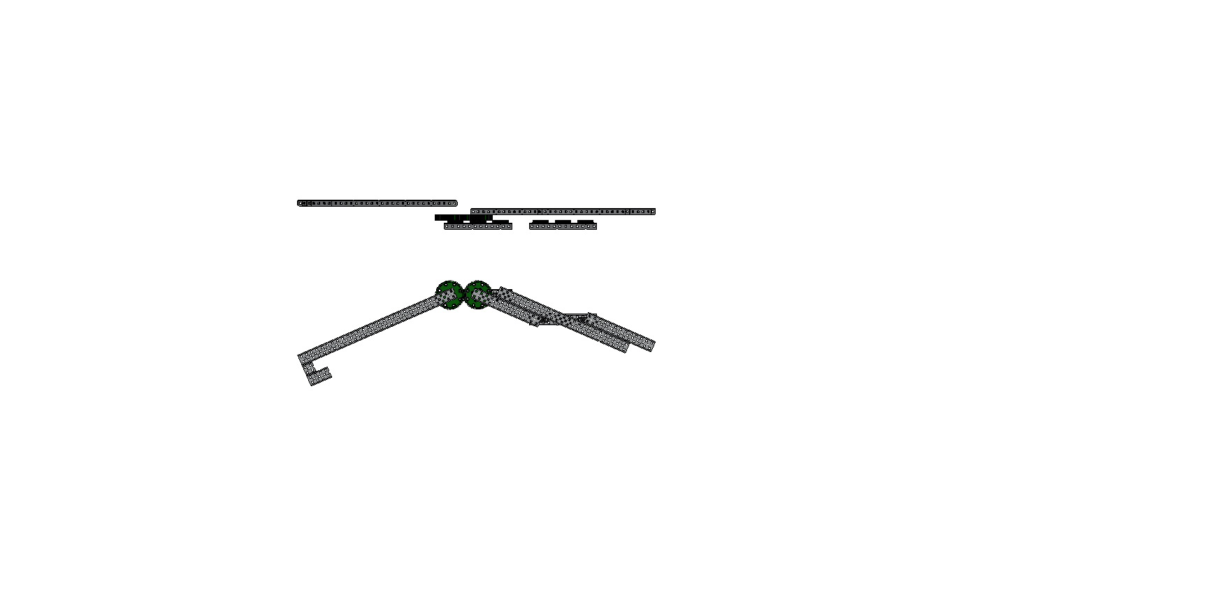

In lue of some of the hanging discussions going on, and some of the gloom and doom around the subject - I figured I’d toss the community an idea I came up with to show that hanging really isn’t impossible, that it can not only be made practical but that it can be done without that much extra added complexity to a robot that can already score in the high goal.
All in all it’s a low-tech solution, but with some tweaking (get the center of gravity right, lock the bar, etc) it might just work out for somebody.
So here it is …
Clicky clicky for high-res
As always run the numbers for yourself before considering this approach, I will warn that these numbers are somewhat sensitive. It only works with a lift that is already able to reach up to 24 inches (which doesn’t have to be a four-bar), but it eliminates the need for these super-lifts that can go all the way to 40".
I like it. Discuss below. -Cody

This looks like a pretty solid place to start for hanging mechanisms. The only think that I don’t like is that it requires two power sources (one for the main lift, one for the hanging extension), so I made a few tweaks to make the hanging extension operate on the main lift’s power source assuming you use a chain bar/4 bar/6 bar/8 bar/etc. The following image depicts my tweaks, but like Cody’s sketch is by no means ‘build ready’.
The lift would operate similarly to a double 4 bar VEX Gateway 2011 - Reverse Double Four-Bar - YouTube
The problem with that is that it requires MUCH more torque to use. So instead of an arm that is ~16 inches long, you increased it to an arm that is 28+ inches long (plus extra friction). Also, an additional power source could simply be a piston, which for one actuation per game isn’t much at all.
Last year I did some tests, and I know (by accident :wink: ) that a ~1:4 18 inch 4 bar is capable of lifting about 6-8lbs, depending on the battery level. Given that information, if you build light, I couldn’t see hanging being much of an issue this year doing it “Cody’s way”
How do you do the math for that? I’ve spent the last month trying to figure out what I could lift with different gear ratios and a four-bar, but I have no idea where to even start.
The numbers posted previously where from experience. I personally found calculating torque & gear ratios unreliable (to a point, what you can lift tends to be how well you build your lift). However, it can still be very useful especially early on in the season. You’ll want to look into how to calculate torque on arms and levers.
Here is an example. Try googling things concerning calculating torque.
http://hyperphysics.phy-astr.gsu.edu/hbase/torq2.html
I hope that helps somewhat. I would invite somebody else who knows more about to post about it.](Torque - Wikipedia)

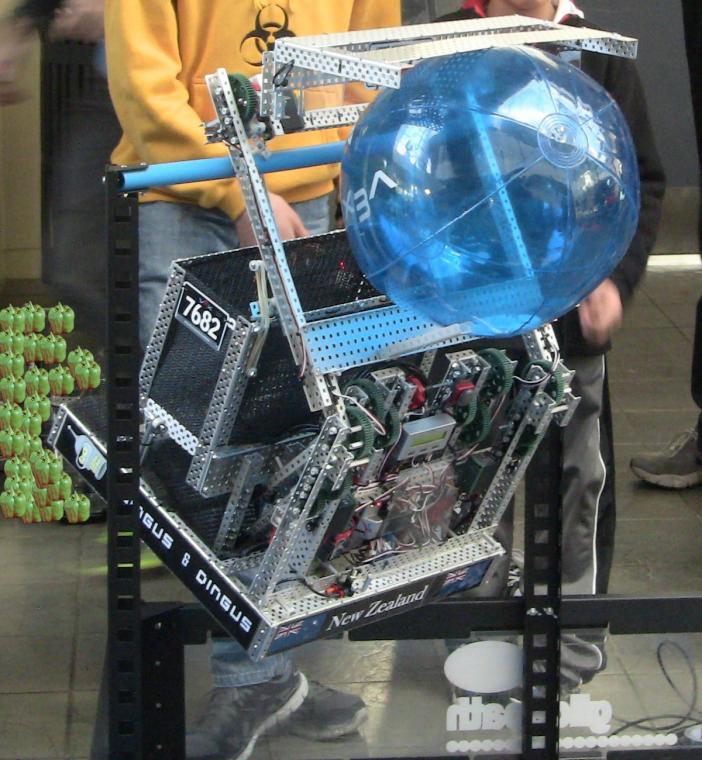

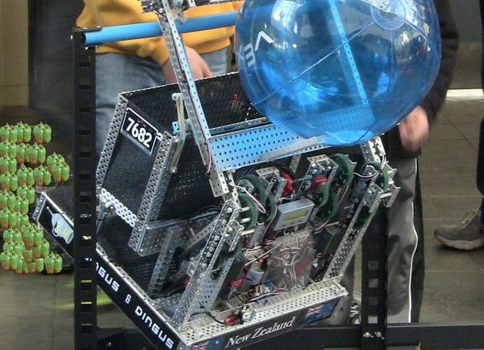

You mean like this?
[ATTACH]7543[/ATTACH]
NZ scrimmage 29 June.
And yes, this is our Sack Attack robot with a couple of hooks on the bucket. :stuck_out_tongue:

for a moment i was like daaaang, new zealand does it again. Then i continued reading:p. Very very nice though:D. Couldn’t you modify your storage system to shoot bucky balls? it looks like it has a pneumatic lock and elastic attached to an arm which can overextend,

I realize that it’s somewhere around double the torque and I’m all for pistons, but for a while the teams that I was a part of did not use pistons and I know that there are still many teams that do not use pneumatics and this would allow them another option for hanging that would fit right in with other designs previously explored on this forum.
Twas one of those details I chose to leave out…
http://polynomic3d.com/user/smith/hanging2.png

I believe the original poster was talking about how to control the hook so that it is down when under 12 inches, but will stretch upwards when the lift is all the way up. Interesting though that you erased some of the picture :wink:
Problem with this is that presumably you restrict to only one robot being able to hang at once. COG can be fixed by moving the hook back and forth a couple of inches until it’s right.
