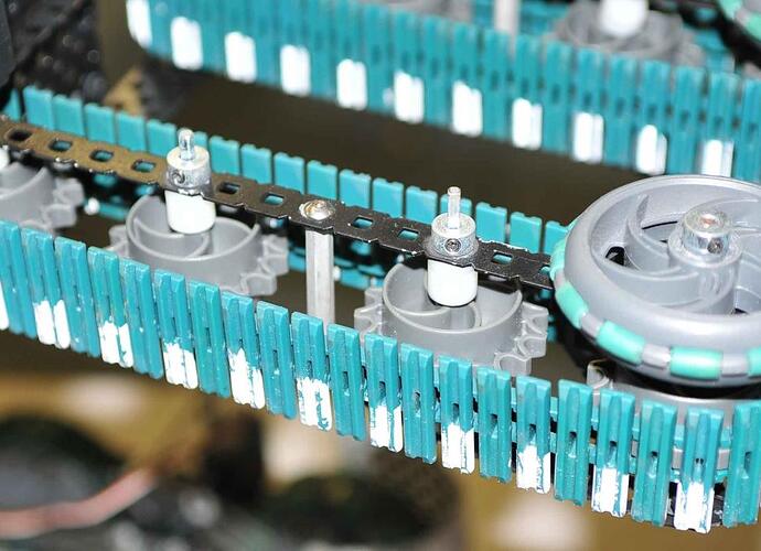

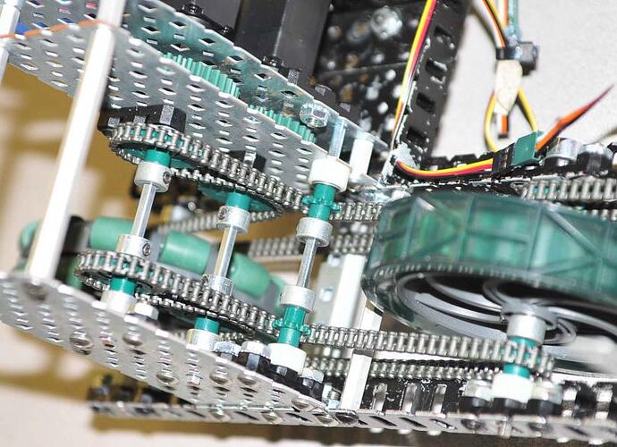

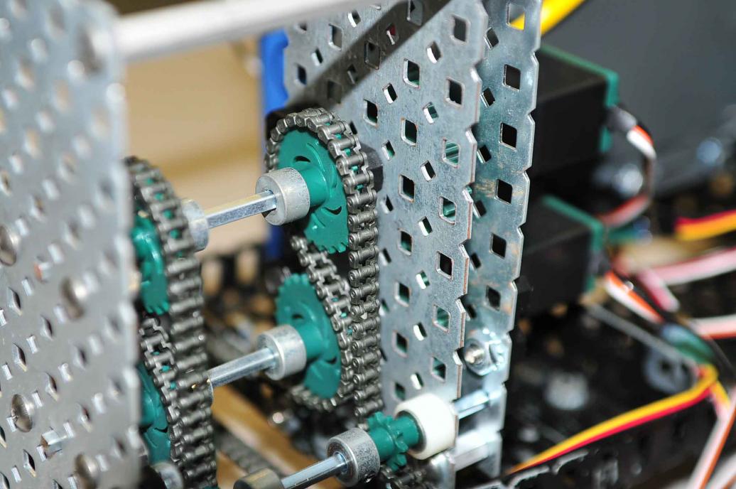

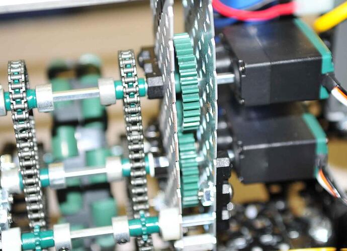

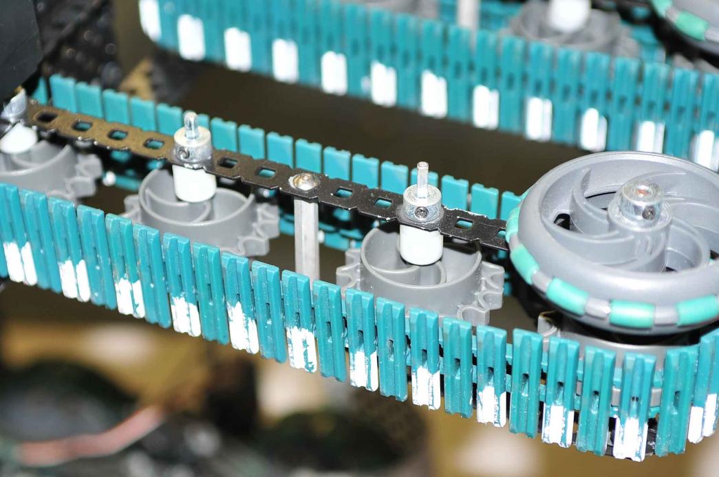

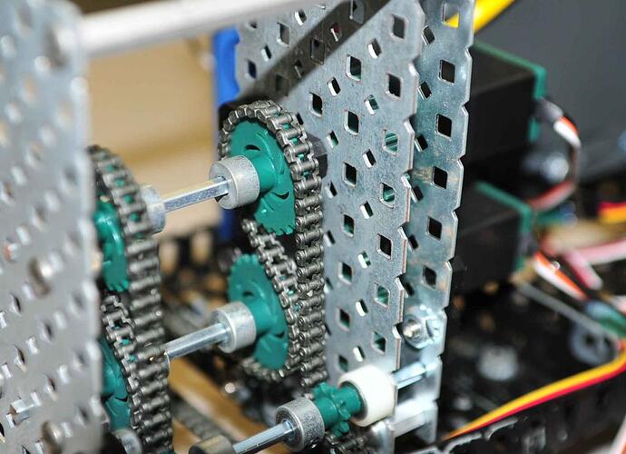

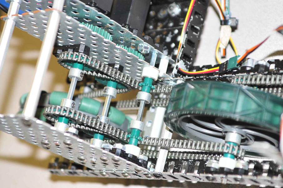

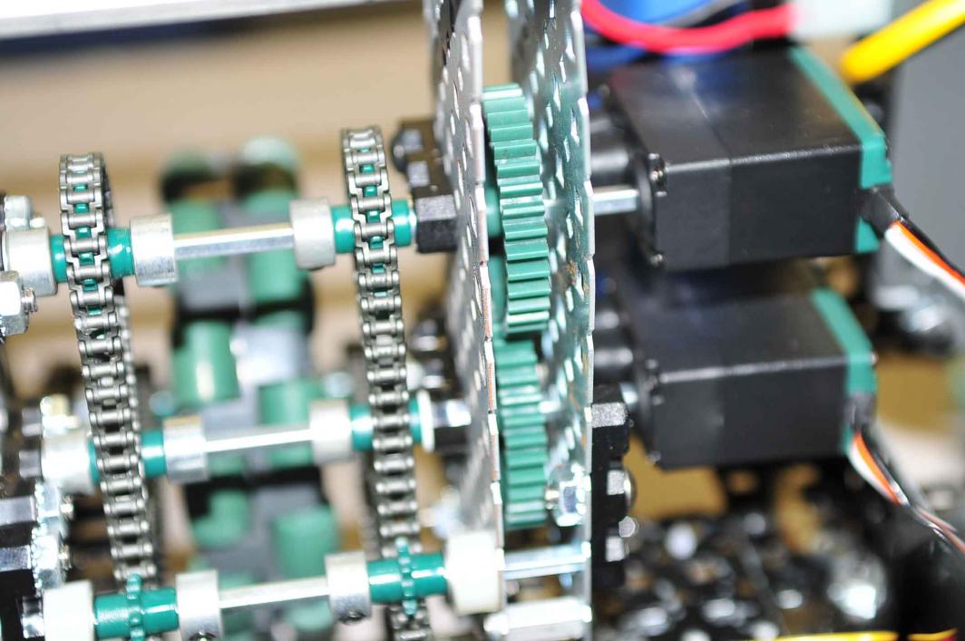

Here was our final solution to our drive system:
We stacked 2 motors and geared them to drive the rear 2 wheels with twin
chains.
[ATTACH]1686[/ATTACH]
[ATTACH]1691[/ATTACH]
[ATTACH]1696[/ATTACH]
The way we overcame the need to put any zip ties on our treads was to re-enforce the treads in the center, and put the smaller omni wheels in the front for pickup and disbursement.

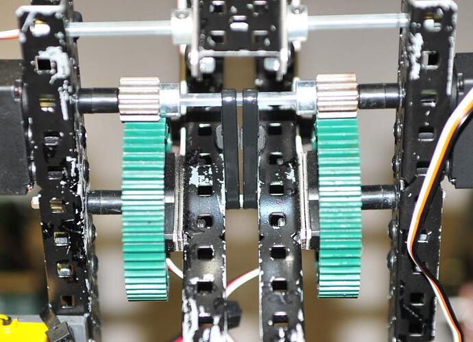

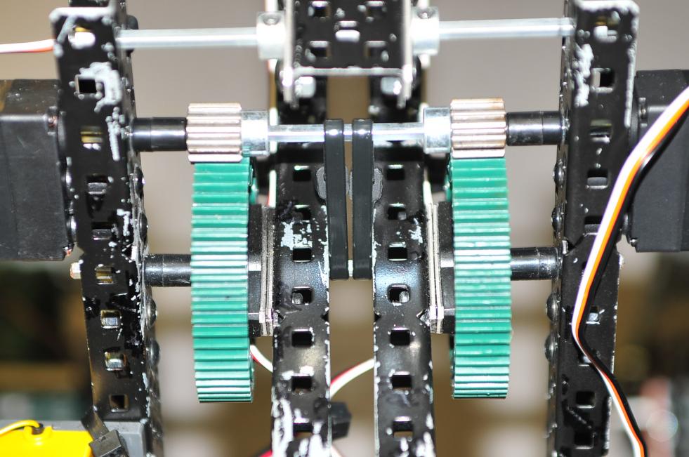

We noticed a lot of “grinding” and “crunching” sounds during the competition as robots were lifting and lowering their arms – painful to the ears! While some of the crunching appeared to be part of “normal operation”, in a couple cases, we noticed that it interfered with ability to lift properly. Although our design isn’t particularly original, we thought a couple pages (1 and 2) from our journal might be of benefit to the community.
We had some similar issues, but made a quick fix with a couple of zip ties. It kept the gears together and eliminated all the grinding. THe new heavy duty gears were awesome too.
[ATTACH]1711[/ATTACH]
We regularly install those on our gears (non heavy-duty), and they seem to work fine, so we won’t be buying any heavy-duty gears until IFI releases a 84- or (dare I say) 108-tooth version.
http://bcpvex.uuuq.com/Web%20Images/v.09.05.01-small.jpg
The 60-tooth gears above our drive train that have screws in them are concealing metal bar locks. The 84-tooth gears on the arm do not, since the slider is screwed straight to the gear - the shaft itself is taking minimal strain.
