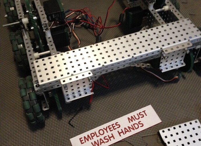

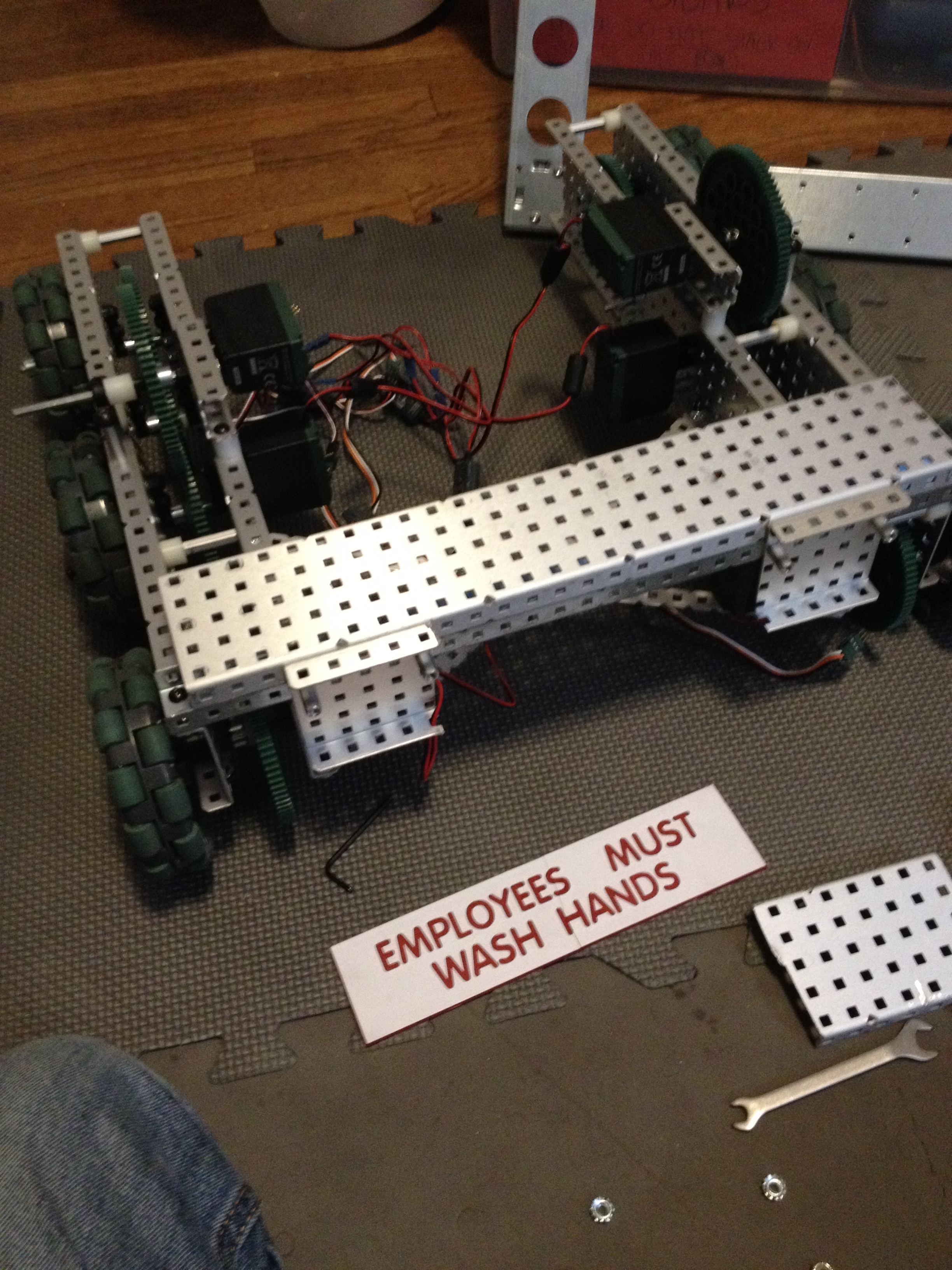

here we are. works splendidly, never had any issues with it. sorry for the bad picture, its all I have now. Its a 6 motor, 6 wheel 1:1 High Speed drive with locked omnis. can easily park and can even give a v5 robot a run for its money on the platform.
@Xenon that looks cool! real question is, did you wash your hands?
thanks. we cut off 5 holes from the ends sticking out on the front btw, so we’re safely in sizing.
indeed… that sign’s our bumper right now.

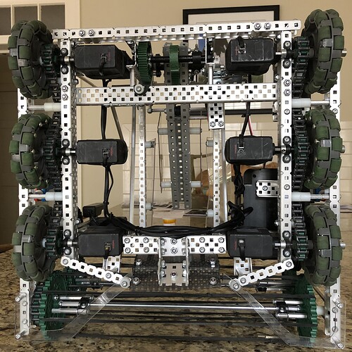

Here's a picture of our 6 motor v5 chassis. The middle wheels are locked, which I would highly recommend for any kind of robot because whether you're lining up to high score a cap or trying to aim your shooter, getting pushed sideways all the way across the field can be a bit of a setback. You probably already know this, but only one set of wheels should be locked because otherwise your robot will have some difficulty turning.
The reason our wheels are not evenly distributed from the front end to the back end is to give us room for our intake. There isn't really a reason anyone should need an intake as wide as ours, but the massive intake is actually my favorite part of my robot because of how easy it is to use.
One thing I would change about my chassis is that I would move my wheels inward a bit. We can easily climb the platforms when lined up correctly, but because of how wide our wheelbase is it is can be difficult to line up perfectly. Having the wheels just a bit closer to the center would make it much easier for us to park.
If you are using v5, do be aware that a 6 motor chassis is far from necessary. The sweet spot seems to be 4 200rpm motors, which gives you plenty of speed and enough torque to push most other robots around, and it gives you 4 motors to allocate however you need to the other subsystems. If you have the motors to spare though, a 6 200rpm motor chassis is a joy to use since nobody has a hope of pushing you around.

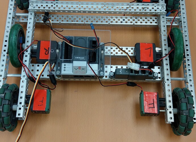

We have a 6-wheel drivetrain with 4 V5 motors. It’s not in the picture, but we do use chain and sprockets to connect the otherwise idle front wheel. And the pic doesn’t have our superstructure on it because this was testing stage months ago.
We do use red torque V5’s but no manual gear ratios, and it’s still more than enough to push off other V5 robots from the center platform. One issue is how close we cut the distance between the wheels and c-channels, so we have to vice-grip the metal away once in a while so the wheel doesn’t get caught.
@P_Mania dang that’s OP. I like the wire management, too.

@Royal_Freedom What can I say? I like big intakes and I cannot lie. :​D
In all seriousness though, thank you for the kind remarks. Honestly, this is the first time our robot’s wiring hasn’t been a complete jumble. It’s nice to see that someone noticed the extra effort. I’ll look forward to seeing what your chassis has to offer. It’s always interesting to see how different people go about constructing the same thing, even with something as simple as a chassis.

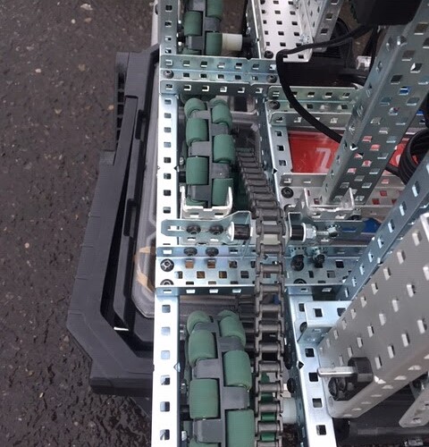

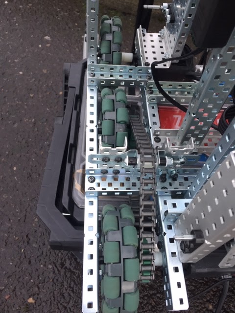

Alright, @P_Mania and @Shard here’s half of my drive. It’s the same thing on the other side, and I didn’t want to leek a pic of the whole thing (ツ). What do you think of the chain tensioner?
I like it. If I was to make the same type of tensioner, I probably would have supported the screw holding the spacers using axel locks connected to standoffs. The way you’re suspending it seems a bit clunky, but hey - if it works, it works. :​)
Edit: I just threw together some parts to clarify. Here’s a picture of what I’m talking about:
