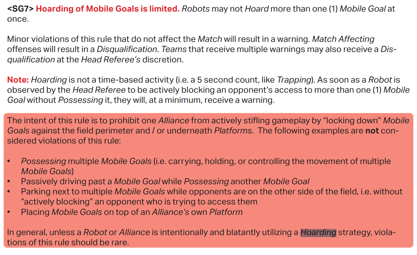

Relevant rules violated:

Part I’m questioning:

But the red mogo can still constitute being hoarded by this rule:
The red robot is blocking the red mogo, so it’s hoarding 2 mogos.
Its not hoarding two mogos because it’s possessing one of the two. it is hoarding the red mogo, but there is no second mogo its hoarding. In the description you just posted, it notes that if it blocks an opposing robots access without directly possessing it then it is hoarding. Since it is possessing the neutral mogo and hoarding the red mogo, this is legal.

Ohhh is see what you mean.
So yeah, they’re possessing one mobile goal and hoarding one mobile goal
