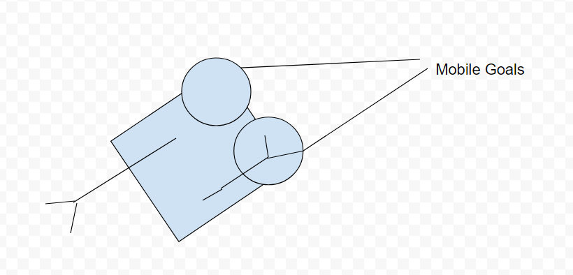

I was thinking you could raise your drivetrain a whole bunch, carry two mobile goals on the back of your bot, and then have a set of alternating chain bars that could get about 7 cones. I still don’t think this would be good enough for the late season, though, you would always lose the high stack bonus. Also, you wouldn’t be able to score more than 28 cones, and I’m pretty sure a fast DR4B or scissorlift could equal that. Also, you would for sure lose the high stack bonuses, and having been in competition now I’ve found them to be a lot more important than they look.
Here’s a picture of the idea:
It could be good for skills though
It could. I still might be able to use the motors to make a fast enough lift that it would be pointless, though, so I think I’m going to stick to that for now. Besides, that gives us a shot in tournament as well.
