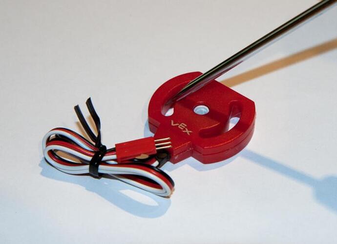

The hard part of this process is opening the potentiometer enclosure, I used a small flat blade screwdriver and pried them open on the inside of the slot where they are normally attached to the robot.

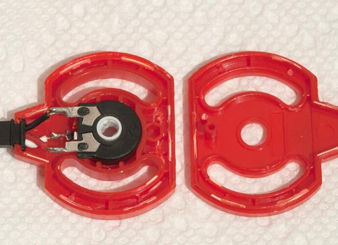

Once open they look like this.

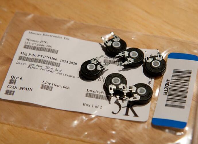

I found replacement parts at Mouser.
Part number 531-PT15NH-10K
The data sheet for this part is here.
I bought 10 for less than $5 (excluding shipping).

Remove the pot completely from the housing, desolder the old pot, solder in the new pot with the wires in the same order. I trimmed and flattened the leads for the new pot before using it, normally this component would be installed in a PCB so it’s leads are designed to hold it in the board prior to soldering.
Here’s a comparison between original and new part.
Put everything back together, make sure the cable relief is in its slot correctly. I used a small amount of plastic model glue to hold the two parts of the cover together.
Takes about 10 minutes.

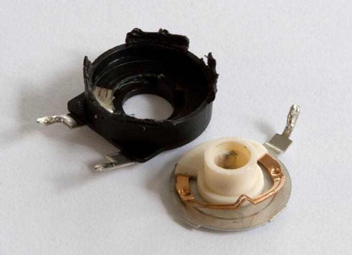

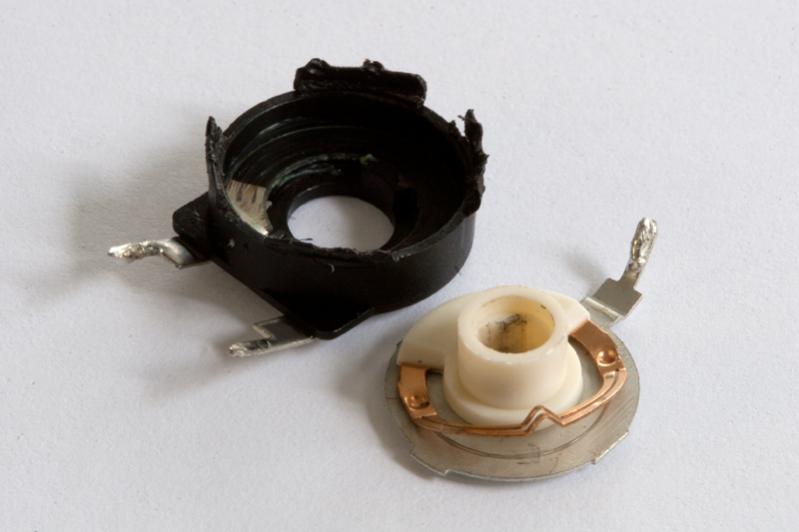

and if you ever wondered what was inside a potentiometer…
[ATTACH]7486[/ATTACH]
That actually makes alot of sense. It’s a much simpler part than I was expecting.
