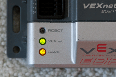

The status LEDs on the cortex are used to display the battery status as follows.
Non-competition mode.
Main battery
6.5V___________ ROBOT led is green
< 6.5V and >5.5V__ ROBOT led is yellow
< 5.5V___________ ROBOT led is red
Competition mode
In competition mode the cortex will switch between main and backup battery if it is connected. The switchover occurs at 6.2V as main battery voltage drops and switches back when main battery rises over 6.9V. Main battery monitoring also happens but instead of causing a solid led indication the led will flash.
Led indications on the cortex are at best confusing due to the many different things they try to convey. In an attempt to document this I have started to put together some animated gifs that simulate the displays. The following shows standard competition status when using VEXnet.
Competition / Disabled / Single joystick / Good main battery / Good backup battery
Competition / Disabled / Single joystick / Low main battery / Good backup battery
(robot flashes yellow)
Competition / Disabled / Single joystick / discharged (or disconnected) main battery / Good backup battery
(robot flashes red)
Competition / Disabled / Single joystick / Bad backup battery
(robot flashes fast red, main battery status can not be displayed)

Led display when the user cpu has crashed.
Competition / Disabled / Single joystick / Good main battery / Good backup battery/ User cpu crashed.
(robot led flashed red, notice led is mostly off compared to low power condition where it is mostly on)
In this situation I observed the following behavior.
  1. User program has stopped operating, there is no joystick control.
  2. Motors on all ports (1 through 10) maintain their last commanded speed
  3. VEXnet communication is still working, the game led follows the state of the enable/disable and driver/autonomous selection on a competition switch, however, the motors can not be disabled.
